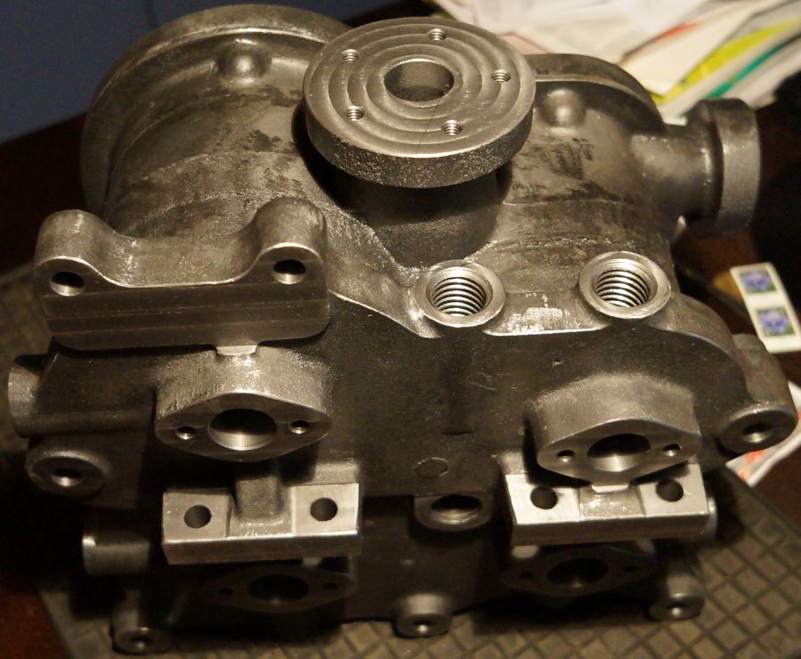

Here you can see how we transfered the alignment from the bottom to the top. Luckily we could pick the bore of the piston rod bushing through the LP-cylinder.

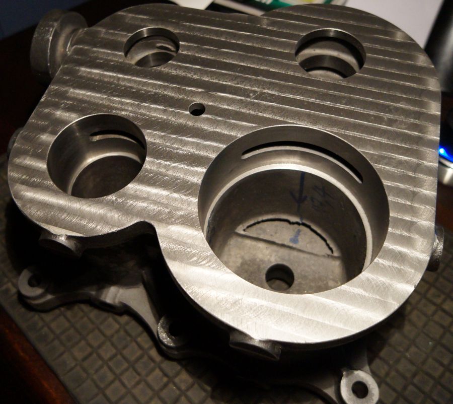

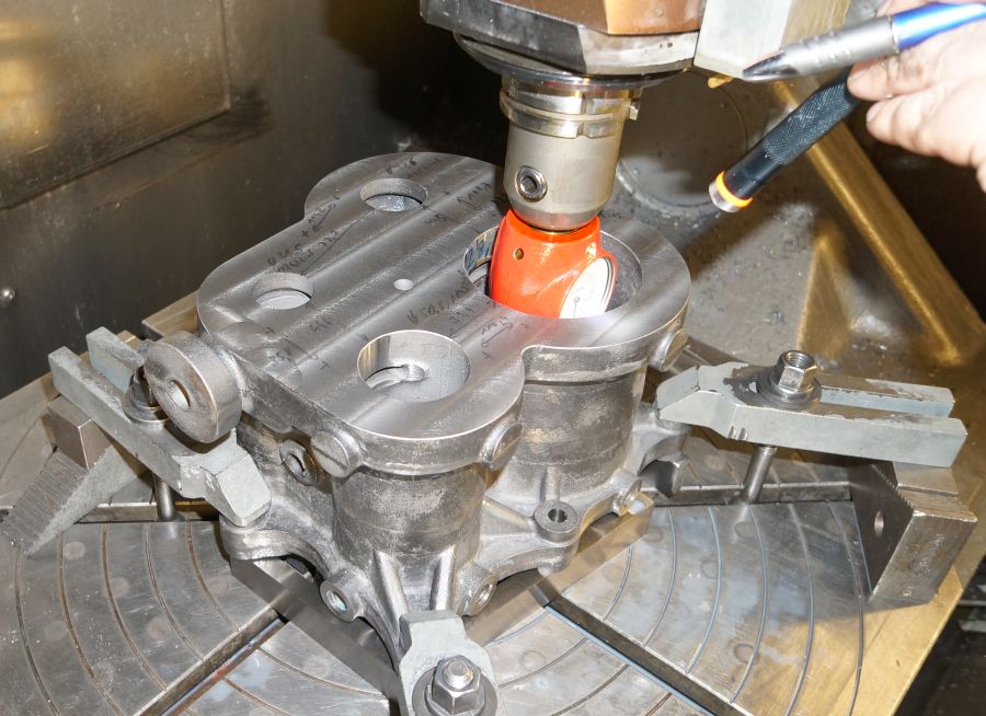

That's all for this weekend.
Top surface got final machining.
In total we machined away 2.1 kg till now.
Actual cylinder weight is 19.4 kg.
All bores and threads could be machined at it's design positions.
No changes because of the casted part necessary.
Don't know how we will machine the 4 big bores - till now.
Actual this bores are circular milled 40 mm in depth.
Maybe we will find a 120 mm long mill to do it this way down to the bottom.
Still 1 mm left (on the radius).

Unless a large diameter cutter is used (and that is no guarantee) at that length, the cylinder is going to be tapered due to tool deflection. I would face the bottom of the cylinder/rough out the cylinder wall with a long cutter and then use an adjustable boring head and a standard boring bar to machine the cylinder wall.

Yes Ron, I agree with you - this would be the best way. Unfortunately I do have a 120 mm long dia. 30 mill but no small long boring bar for dia. 35 mm as needed for the HP piston valve - but let's see...DetroiTug wrote:...I would face the bottom of the cylinder/rough out the cylinder wall with a long cutter and then use an adjustable boring head and a standard boring bar to machine the cylinder wall.-Ron

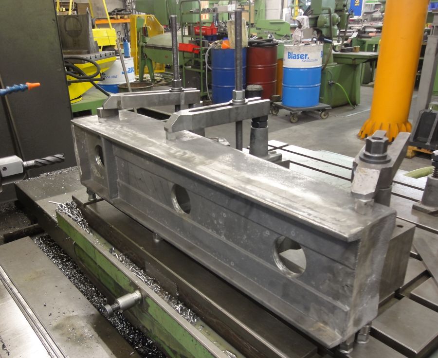

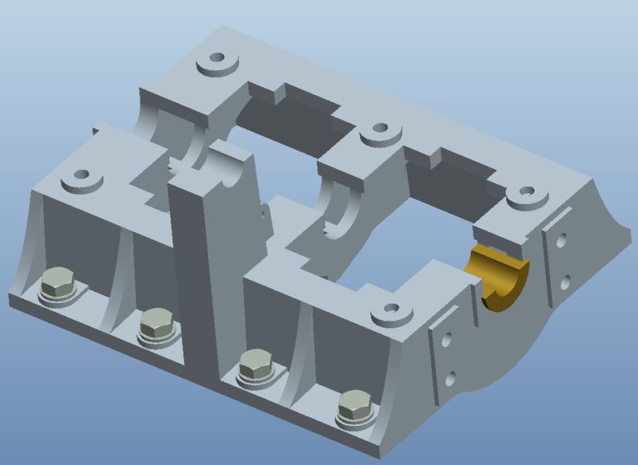

Because in the moment I can not use the big CNC mill for the cylinder block at work I am redesigning the base according to the Savery design. At the right side you can already identify the flange with 4 holes ready to mount the pump assembly. Off cause the base design is not finished jet!

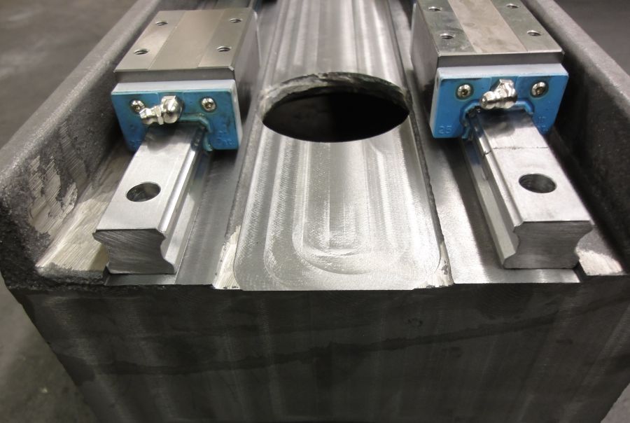

Yesterday my friend and I machined the cast iron part (designed by me) for my home-mill. It's the Z-axes with a z-travel of 500 mm. This will be driven by a DC-servo motor for cnc control via Mach3. Some days it will make me independent from other peoples machines and labor...
