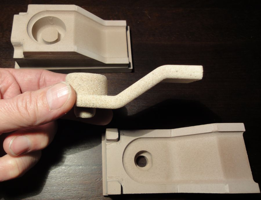

tonight (already 2 o'clock in the morning here in Germany)... I have made my first sand cores from the two fresh made core boxes.

First core box
- I think you can find out which core is for which part of the piston valve chest...
- 020-zb-drehend-4-k.jpg (83.47 KiB) Viewed 130613 times
- Drain chanel (round part going to the right) is added here compared with the drawing above because I need some support for the cores...

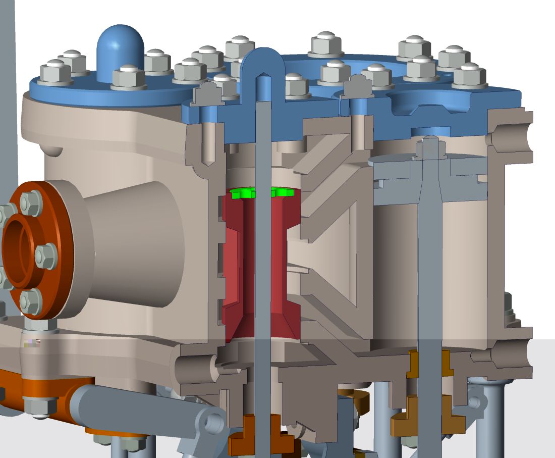

- HP Steam canal height 8 mm (1/3") , width 36 mm (1 1/2") for Piston of about 58 mm diameter.

Re: First core bockes
Very good to see such high quality work you are doing. Far beyond what most of we steamboaters are capable of.
- Aheadslow
- Posts: 62
Very nice cores, they should leave good clean cavities. . are they Sodium Silicate Co2 bonded cores ? and what are the molds made with ? I do not recognize the material.
Thanks for all the roses!
It was a long and time-consuming way to learn all the technologies - steamboating - CAD - CAM - machining - core making - till I could hold this in my hands. And it will need some more month till I can hold a cast iron part in my hands.
So it is good to have the possibility to show something here and to get back some warm words to stabilize my endurance ...
Now the answers to your questions:
- yes, the cores are from CO2 bonded Silicate
- the core boxes are made from SikaBlock® M650 plates - normaly also used to make "clay models" for car prototypes etc. This is expensive material but it saves much time because you dont have to paint and grind and paint it like wood after machining. You can make the cores in it right when it comes from the mill.
- all was done on a simple 3D CNC mill controled by the popular Mach3 software http://www.machsupport.com/.
- using a 6 mm ball nose mill.
- because the resolution of the milling steps is 0.2 mm = 0.007 inch and the max feed rate of 60 inch per minute it will take about 3 -4 hours to mill such "smal parts" like shown here.
So the main parts for the cylinder pattern has to be made on an commercial mill - if not, you will become crazy of waiting for results...

Ranier-
That is a nice core, and a nice 3D model.
I have tried a fine silicate sand recently, and as long as I followed the recommended mix percentages, and mixed well in a blender, then the cores worked very well, and with very smooth surfaces.
What modeling program are you using?
Can you show us a screenshot of the engine model?
I am using pro-engin eerSteamGuy wrote:Ranier-
Have a look here:Can you show us a screenshot of the engine model?
http://www.thesteamboatingforum.net/for ... ?f=4&t=577
Or at my homepage -> see signiture

I assume you are doing simulation runs using ProE on your engine? I have found the engine simulations to be invaluable for pointing out inteferences, collisions, etc. as the engine is running. (I use the base package of Solidworks).

Yes it is easy to do. You have to set some points on the valve and the piston and instantly you can watch a graph of timing!SteamGuy wrote:I assume you are doing simulation runs using ProE on your engine?
