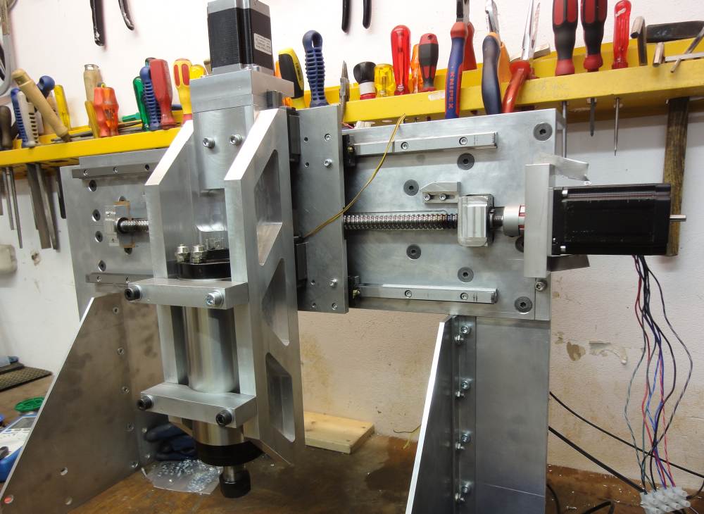

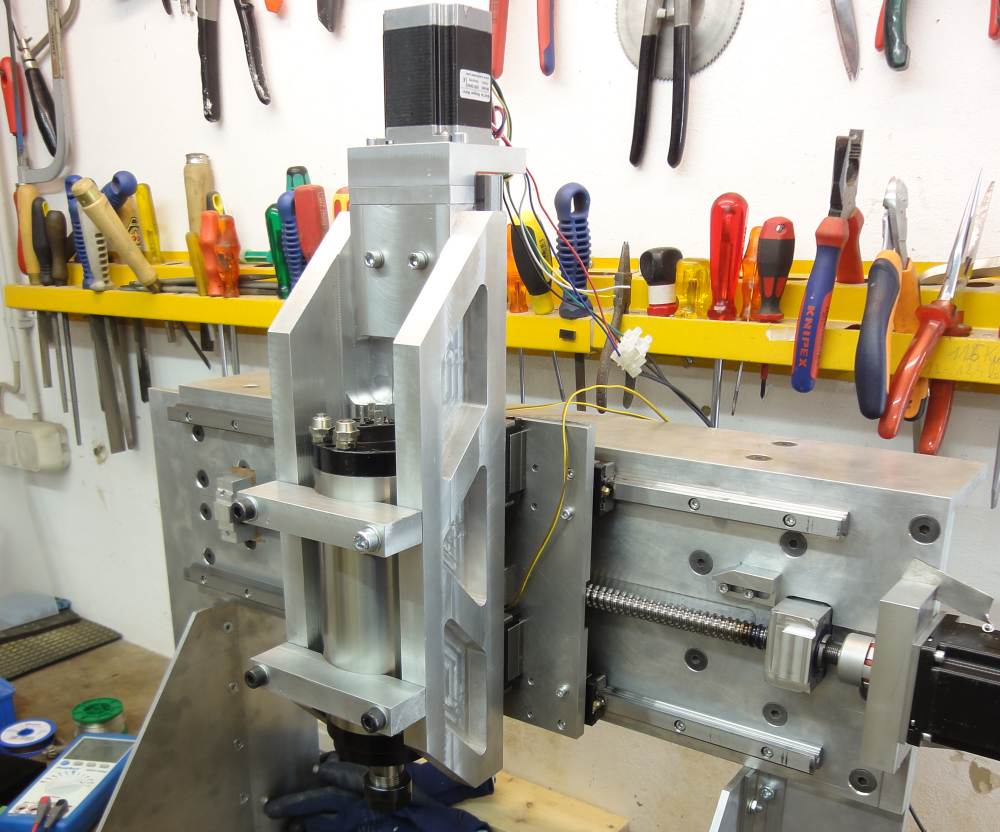

Some progress with the pattern CNC-Mill:
160 mm Z travel plus the possibility to move the spindel up and down in its fixture to archive the full workspace range of 200 mm unter the x-axis bridge
Did all machining with my home upgraded CNC-mill.

That is a nice looking machine.
Well done.
Pat J

Hi Rainer
That looks an excellent machine. Well done!
If you should decide to build a better Mark II version, can I have the old one???

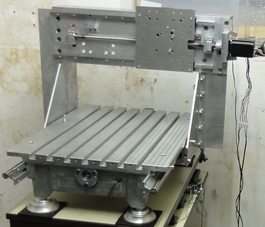

Post by Rainer »
Thanks for all the warm words. Have it together and at the table. Now I have to align everything. Not a problem in the range of some +/- 0.5 mm (0.02 inch) but it should be at least one power better (= 0.05 mm/0.002inch). Therefore I have to think about an adjuster.
Re: First core box
If your errors are consistent, you may find it simpler to construct a error model of the device in software and do correction that way. I've used that technique to correct CMM errors with good results. If you can automate creation of the error terms, renewing the maps after disassembly (or crash!) is much easier. I used squareness terms, straightness maps (interpolated) and linear axis roll terms to compute the forward & backward kinematics of the CMM; by calibrating with a laser interferometer we were able to hold ~.005" over a 360" x 36" x 36" working envelope until the next time someone banged it with a forklift or the factory temperature changed.
Re: First core box
Bart, what language are you writing in? It's all "Greek to me"
Re: First core box
Rainer is using Mach3 as the CNC control program I think. It has "screw mapping" where errors can be corrected over distance and it also has "backlash compensation" where a value can be set for the amount of lost motion in traverse, the machine quickly moves across that on direction change, the positional DRO does not reflect this movement. Ideally there should be none, but that is impossible even on the most expensive most precise machines made. Real world factors like thermal expansion, friction, lines of force, deflection of components etc prevent true "zero backlash".
