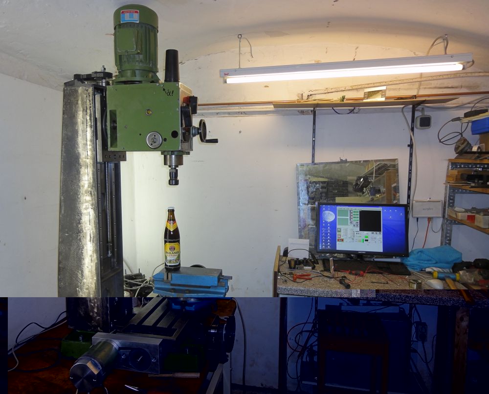

But I finished a small cnc mill project which enables me to mill smaler parts at home again (x-y-z travel = 400 x 220 x 500 mm) and hope to finish my also long term project of my own home stationed pattern making cnc mill (x-y-z travel = 380 x 420 150 mm) with water cooled 2.2 kw HF China milling spindle.

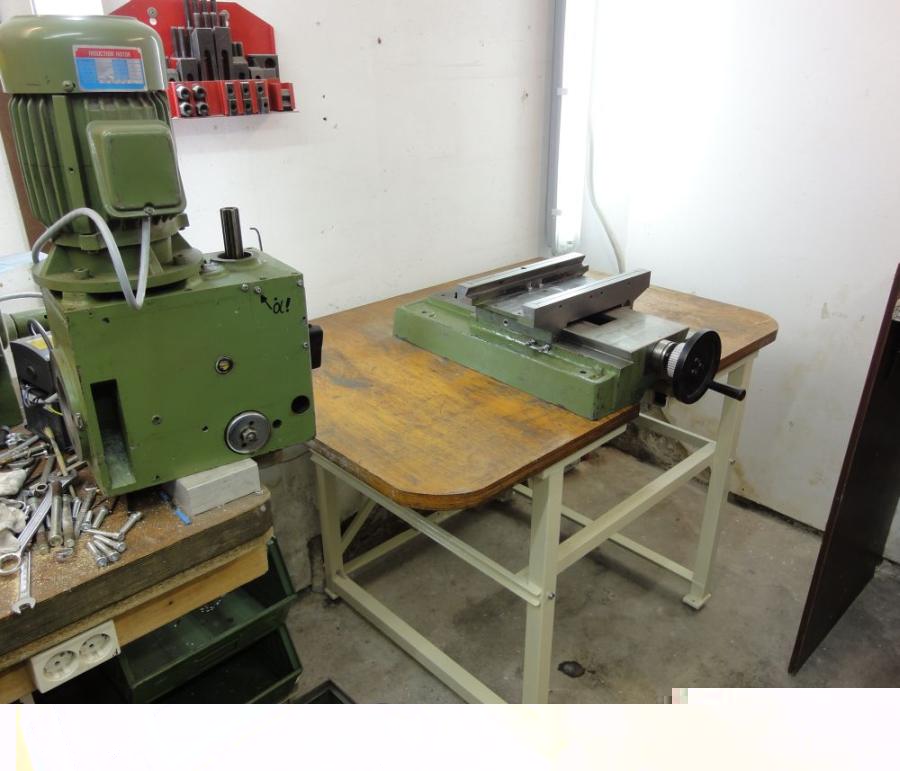

The old base - fresh grinded - with ball screws and 400 Watt 50 Volt DC-servo motors on all 3 axis.
Old milling gear box with MK 3 tool taper and 1 HP 380 Volt 3-phase motor - at the left.
We are lucky to have 3 phase 380 Volt in virtually every German household as standard for the electric stove and baking oven in the kitchen. If you are lucky you can "pick" the 3 phases direct in the cellar - as a student I also had a free wiring from the kitchen in the rented flat through a dead chimney into the cellar.
New z-axis with German standard 1/2 Liter returnable beer bottle as scale.

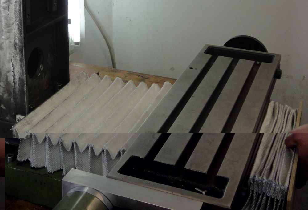

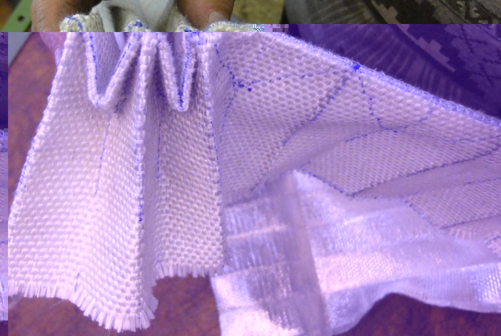

Self made guide way protection from glas fabric.

It's working:
Accuracy is quite good - less than 0.04 mm = 0.0016 inch - over a distance of 400 mm = 15.8 inch measured with a marbel triangle.
