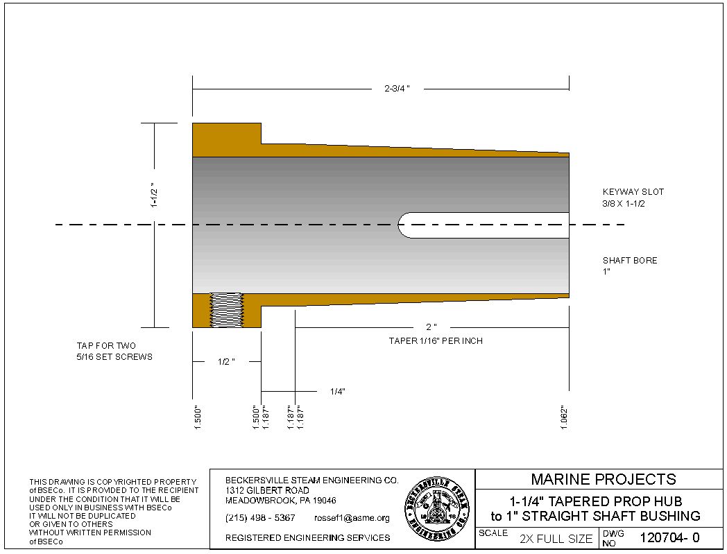

For a 1” straight shaft, this is the bushing you need.
I am assuming you have a key on your shaft, either 1/4” or 5/16 inch to take the torque of driving the propeller. A key is necessary here to take the torque of the drive shaft. The set screws hold the bushing to the shaft, and probably need a small countersink on the shaft to allow the set screws to bite properly. These set screws take all of the propeller thrust force, so some countersinking where the screws bed down is prudent. The prop and key then go onto the bushing, followed by the fairwater nut on the end of the drive shaft. Lightly tightening the fairwater nut will push the propeller onto the tapered fit, and off steaming you go.
Some alternates you might consider temporarily, use ordinary shaft collars and just make the tapered part of the bushing shown on the attached drawing.
If you do not have a threaded shaft for a fairwater nut, then you can use an ordinary shaft collar again here. Without the fairwater nut to press the prop onto the bushing, use removable Loctite (Thread Locker Glue) to put things together. Just clean everything, apply Loctite, assemble the parts as firmly as you can, tighten the collar set screws, and let things stand overnight.
As far as materials for these parts, Bronze would be the first choice, ordinary steel is a reasonable alternate.
This setup is not for the kind of power that the propeller is capable of absorbing (well over 100 horsepower), but it is ok for a couple of horsepower at a few hundred RPM as is your application.
- 1-125BUSHING.jpg (92.78 KiB) Viewed 13379 times
