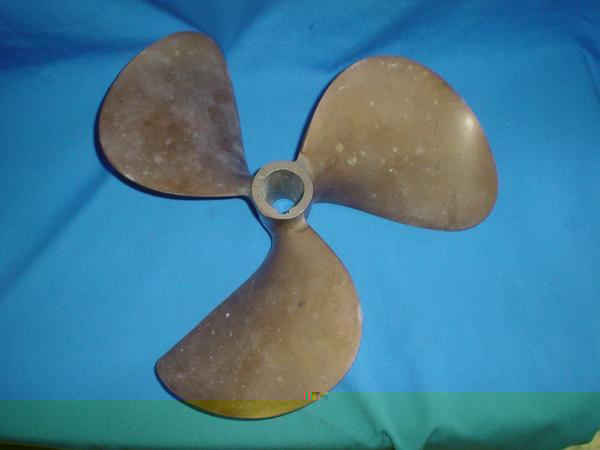

I happen to have a 14 RH 17 Michigan DYNA-JET Prop that was on my electric boat, 1-1/4 shaft, standard marine taper. It is a good 3 blade bronze prop, with a few minor dings & scrapes. I will lend it to you for tryout, if you want it then you can buy it from me, or return via the mail. Being close to what you may need, a 17 inch pitch, it would be a good canidate for re-pitching if needed.
