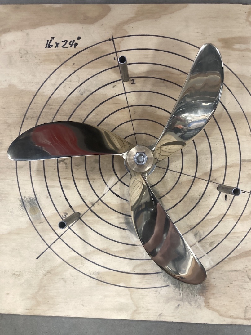

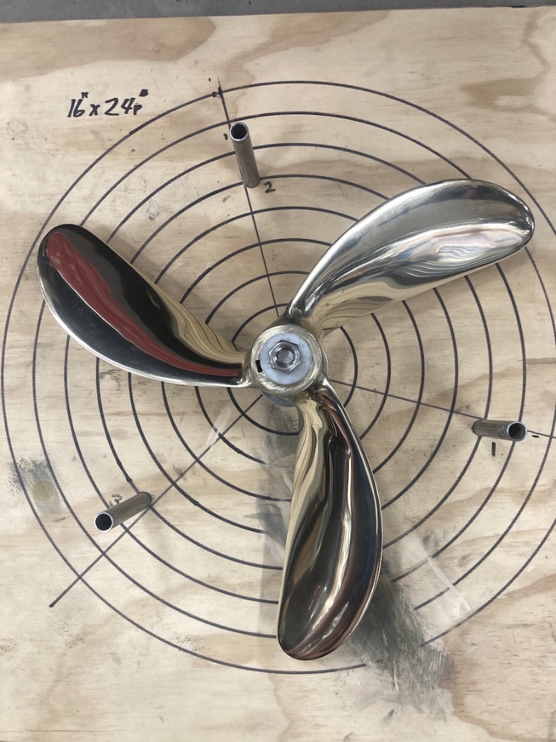

Pete:
These photos are not directly side on, but might help.
The prop is on a layout board I made to finish the propellor, and the circle lines are 1" apart. (2.54 cm for most of the world.)
