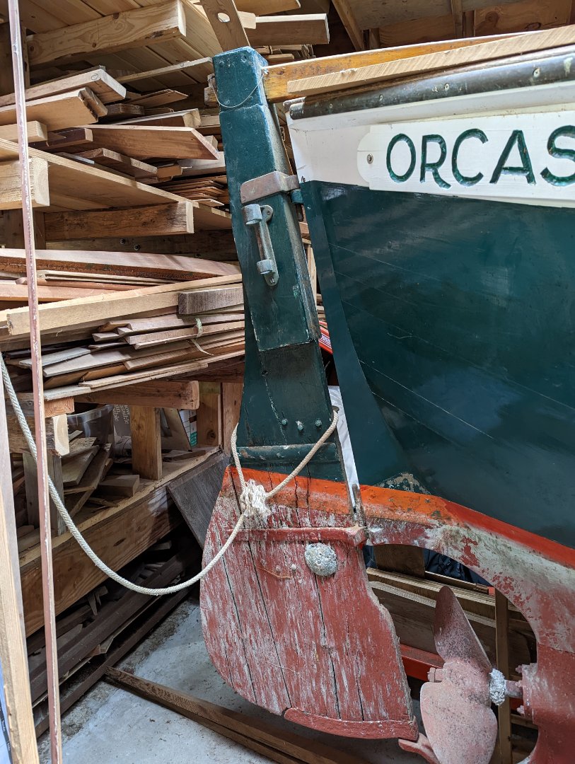

My current boat Vividus, is of conventional design, similar to your photos, and has an Elliott Bay propeller. From the start, she has had much less trouble from weeds, and ejecting them by going full astern is pretty effective. I believe that this is due to the dead wood, skeg, and rudder, all of which provide resistance to hitchhiking weeds freely rotating with the propeller.
The final few weeds that she would be stuck with are effectively dealt with be a hack I learned from Mike Condax. By adding a double edged weed cutter to the stern bearing housing, which takes care of any weeds trying to wrap around the shaft, I virtually never see a weed on my propellor anymore. The source for my blade? An old steak knife.
