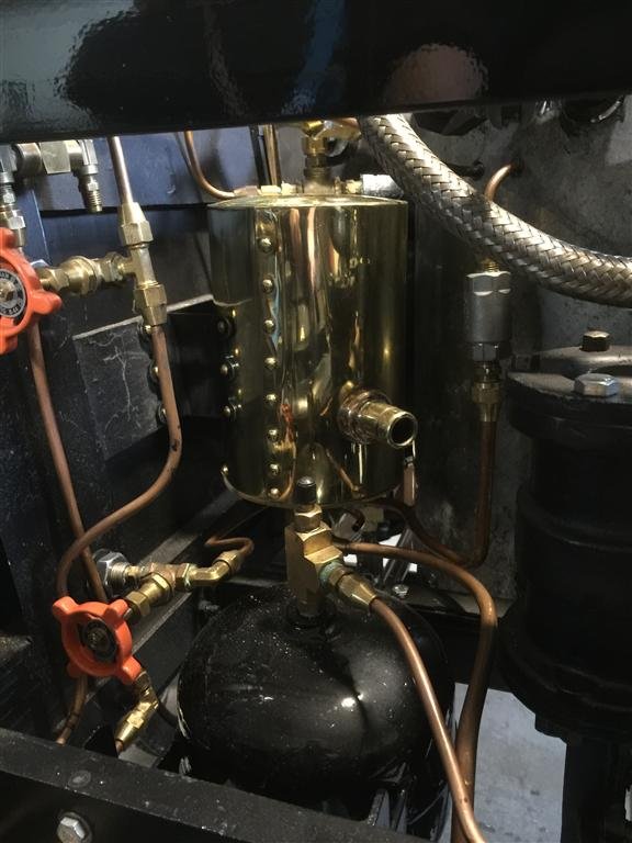

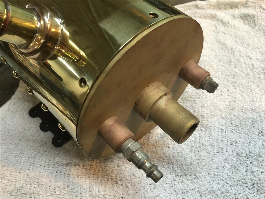

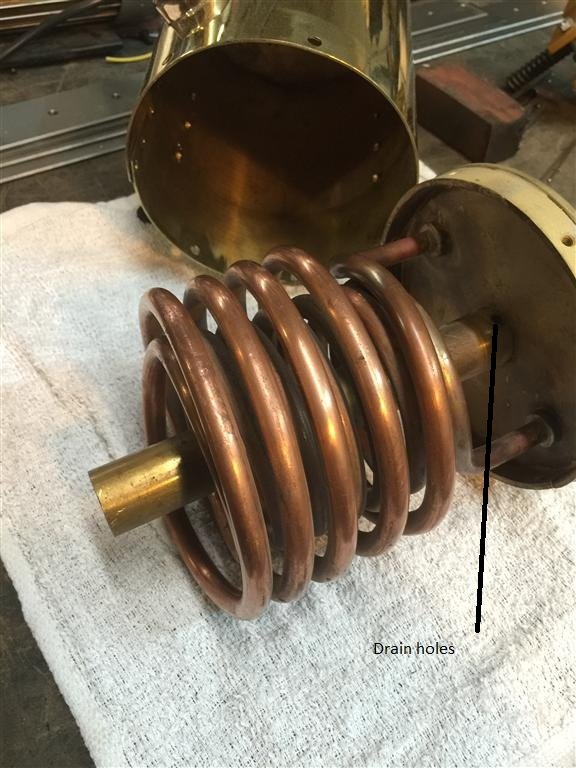

Fred, this is the muffler/feedwater heater I built for an early steam carriage I'm restoring.
