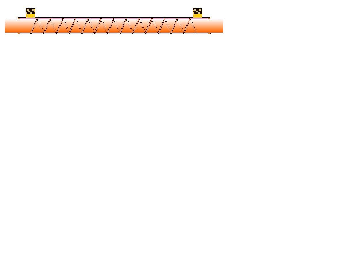

I'd like to know more about that feed water heater. Cute. Wonder if it could be scaled up a bit and whether it's real any better or lower loss than a tube within a tube type. I'd been thinking about maybe 18" long with a 1/2" copper pipe within a 3/4" pipe for my 3 x 4 launch engine.

From Lopez Mike: "I'd like to know more about that feed water heater. "
This is a brazed plate type heat exchanger, somewhat "overkill" to heat the feedwater for our typical steamboat feedwater flow. My tube-in-tube heater is only about 0.4 square feet heat transfer surface area, and brings the feedwater to my boiler, about 80 PPH (pounds per hour) at about 194F with atmospheric engine exhaust (212F). Full description of this heater posted on thread "Margaret S Sidewheeler Recent Modifications" in "Members' Websites and Boats"
The plate type heat exchangers have been used as full exhaust condensers in steamboats, almost 10x the heat transfer duty of the feedwater heater, and I believe Radow uses this setup. I prefer shell and tube type condensers, as it is easier to clean out fouling on the seawater side, with flow inside the tubes.
