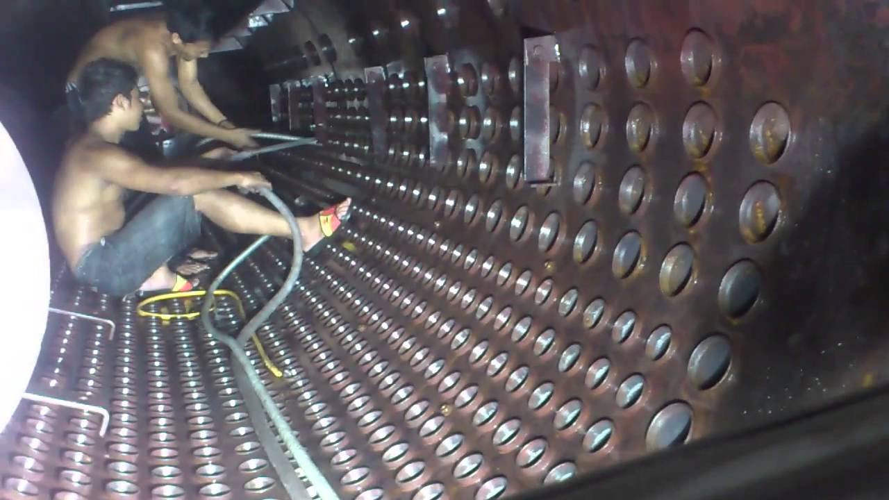

In the industrial power generation realm, watertube boiler drums generally require much thicker sections where the tubes pierce the drum. This is because the costs of materials justify making the wall thickness of the drum variable, and as small as practical. The scale of these boilers is far removed from our steamboats, as illustrated in a few photos that follow:
LargerWTB Drum.jpg (45.22 KiB) Viewed 10111 times

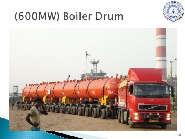

Re: Stress in a Boiler Shell
Delivery of a large boiler drum. The power output from this steam plant is roughly enough to run about 300,000 typical steam launches which require about 3 horsepower each.
