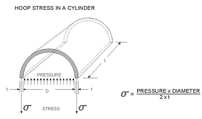

Hoop Stress in a pressurized cylinder, as illustrated in the attached picture.
Pressure Force tends to force the cylinder apart, and is equal to:
Pressure x Area of pressure action = Pressure x Diameter x Length
This Pressure Force is opposed by the metal cylinder wall tensile stress, and this force tending to hold the cylinder together is equal to:
Stress x Area of stress action = Stress x wall thickness x 2 x Length
Setting these two forces equal to one another, and solving for the hoop stress:
Hoop Stress = ( Pressure x Diameter ) / ( t x 2 )
This simple classic equation may be used to approximate the metal stress in a cylindrical pressure vessel, however there are several complications, such as holes in the cylinder wall, thermal distortion, weld seams, welded attachments, end connections, etc., etc. When considering this equation, it is prudent to use very conservative allowable stress values, especially with the potential danger of a steam boiler. For example, the ASME Boiler Code only allows 17,000 PSI hoop stress in the shell of my simple firetube boiler, yet the actual material has a yield stress of over 37,000 PSI, and an ultimate tensile stress of over 70,000 PSI.
Another VERY important requirement for pressure vessels is to use materials that are ductile, so that they can be distorted without potentially producing cracks and brittle fracture when exposed to all the stresses caused by the issues of the previous paragraph. In general, pressure vessel material for our typical launch boilers must be able to withstand a fully closed 180 degree bend, without producing any cracks in the material.

Re: Stress in a Boiler Shell
An additional item to add here is that seams along the length of the drum are more heavily stressed than those around the drum.
Load attempting to remove cap from end of drums is area * pressure = 3.14*r^2 * p.
Area in tension resisting load = 2 * 3.14 * r * t.
Stress in radial direction is (p * r)/ (2 * 3.14 * t), half of that seen in the longitudinal case. Pictures of notable pressure vessel/pipe failures demonstrate this, with typical failures involving longitudinal breaks:
https://en.wikipedia.org/wiki/San_Bruno ... _explosion
This also explains why seamless tubing with welded end caps is the preferred fabrication technique for steam drums. Note that for small sizes, drum/pipe thickness is governed by practical considerations rather than pressure stresses.

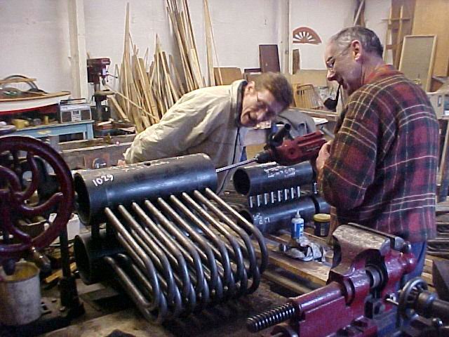

Kelly's explanation about the a row of tubes in a boiler drum is correct, and Kelly indicates that drum wall thickness would need to increase in these areas. That is one option, if the nominal stress is close to the maximum allowable stress. Many boilers are designed with relatively low stress, and if there is enough extra stress value available, then no extra wall thickness may be required.
A good example is the typical two drum watertube boilers made for steam launches (Lune Valley Type), where each drum has constant wall thickness, but maximum stress values are still within allowable limits. The stresses in the vicinity of the extra holes are higher, but still sufficiently low as to not require increased wall thickness.
