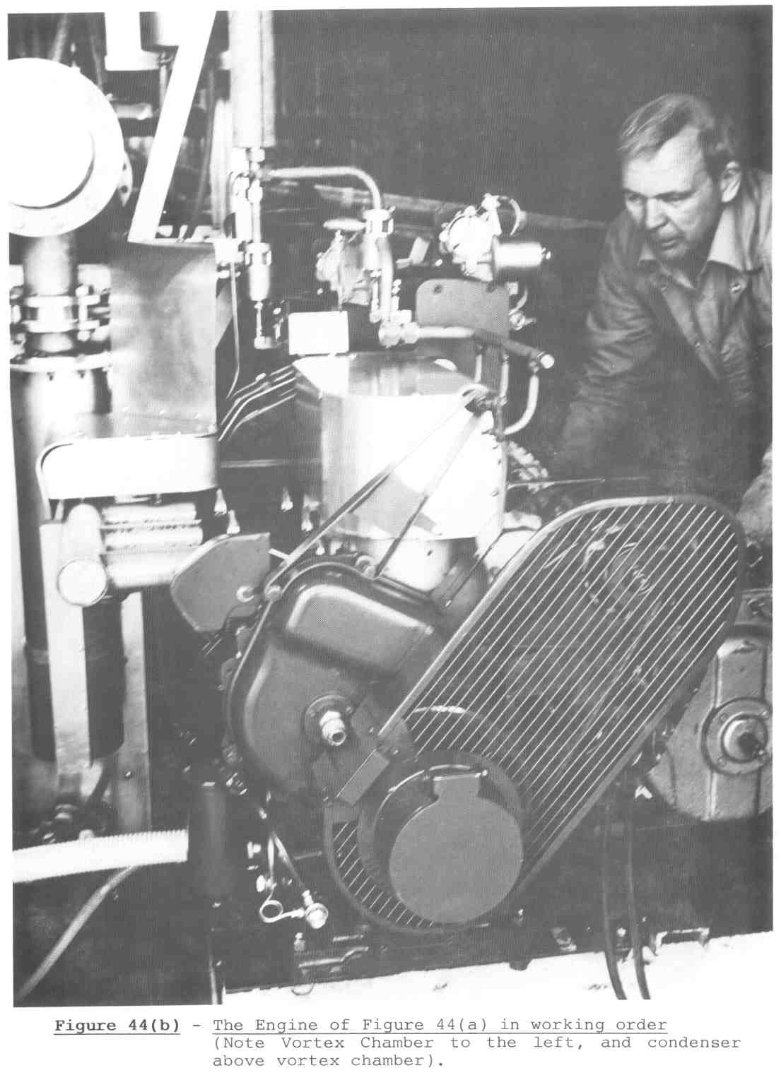

As far as "bash valve" engines are concerned, I have always thought of them as very primitive and unworthy of consideration. However the White Cliffs Solar project used a 3 cylinder uniflow engine with bash valves, and this engine ran reliably for years, producing up to about 25 kW. The bash pins hit the ball bearing type steam admission valves for only a vety short duration, so the low piston velocity when the pins hit the balls was acceptably slow to allow long life. This engine ran with 600 psi steam, about 40 Barg.
http://www.rossen.ch/solar/wcengine.html
This engine is very efficient, the best of reciprocating steam engines I have seen in the last 100years, except for the Skinner compound uniflow engines used to power several US Aircraft Carriers during WWII, but they were engines with thousands of horsepower, a whole different realm.

Re: Theory question: Pressure/temperature limits
Reading the complete report is quite interesting; the detailed descriptions of various problems encountered both in initial development and in maintenance are particularly useful.
One mechanism they describe for oil removal from condensate is the use of stainless steel disks slowly rotating at 10 rpm in the feedwater tank, with some means to wipe the oil off the disks and return it to the oil tank. Those familiar with the problem of tramp oil collection in water-based machine coolants will recognize this mechanism. I don't see any discussion of the type of oil used in the engine; my experiences with oil/water mixtures in Otter's old refrigeration compressor based engine suggest that some non-detergent, non-compounded oil would be best.
Thanks for posting the link!
