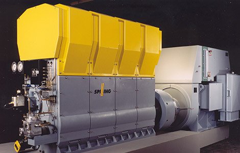

The Spilling reciprocating steam engines as currently manufactured are rated for a maximum steam inlet pressure of 900 PSIG (60 BARg). These engines operate with no lubrication on the steam piston, nor the steam piston valves, which are both made of tungsten carbide.
I assume the 900 PSIG is a convenient designed limit, as it corresponds very nearly to Diesel engine practice. Designing for higher inlet pressures is not a technical limit, however there is little incentive on the thermodynamics to go with higher pressure. As far as temperature goes, this limit is occurring on the boiler end, as the boiler metal must endure temperature higher than the maximum steam temperature.
The highest steam conditions I have ever encountered in steam turbine plants is 5000 PSIG with 1200F steam temperature. I understand these limits are being slightly exceeded in some new Japanese steam-electric plants. Reciprocating IC engines endure working gas temperatures well above this limit, and therefore inlet temperatures for a properly designed reciprocating steam engine could be very high, but then again there is little incentive on practical considerations to go with higher temperature, due to the boiler metal issues mentioned above.
