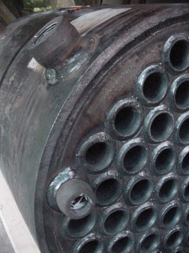

On my Beckman VFT boiler they appear to have used a pipe reducer welded in place. Only a small amount of protrusion from the surface of the shell. This gives me a lot of freedom of choice in the future about how long of a schedule 80 nipple I might like to use. Also, there are a lot of extra ones on the boiler which I have plugged with ordinary pipe plugs and covered up with the insulation and lagging. You never know what you might want to do later.
With proper welding practice, such as the right bevel, it would certainly be strong enough. Black iron (mild steel), of course. No galvanized.

Plumbing supply houses sell "half couplings", which are typically used to be welded to tanks and such. Schedule 40 is readily available, so is Schedule 80. But, I would have to recommend that the proper welded fittings be used, the ASME Boiler and Pressure Vessel Code requires full penetration welds, and the proper fittings are beveled for welding, and held about 1/8 inch away from the pressure vessel for full penetration welding. The proper fittings are A-105 "Thread-o-lets", available at most industrial supply houses.
- 1/2 INCH AND 1-1/4 INCH THREAD-O-LETS
- A-105 Thread-o-lets.jpg (32.64 KiB) Viewed 8841 times
Re: Boiler Penetrations
So there you go! And by the time you apply some insulation and lagging, it will be nearly flush thus allowing you some choice in how you plumb things.
