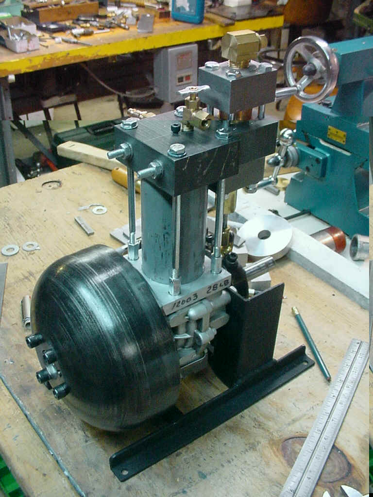

Picture is a 4.7 cubic inch chain saw engine, converted to steam for a canoe.
The compressor you mention is about 11 cubic inch displacement, and with 100 PSIG steam @ 400 RPM you can get about 2 HP maximum. That should be OK for about a 16 foot long launch.
- 4.7 cubic inch two stroke gasoline to steam conversion.

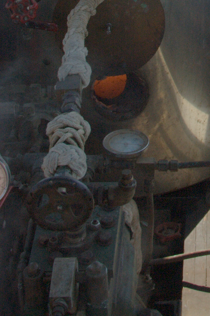

I gotta know, How did you deal with the fact that your slide valve operated at the same angle as the orientation of your drive shaft? Unfortunately, the pictures on your website really don't tell the tale (BTW, you REALLY gotta update that thing brother.) The one really good shot of your slide valve assembly shows it broken. So it's tough to tell how you got it to work.

I used a rocker armWearyman wrote:Bart,
If you do a rocker arm, mount it on needle bearings for minimal fuss.
- OtterEngineDSC_0366.jpg (201.73 KiB) Viewed 29341 times
