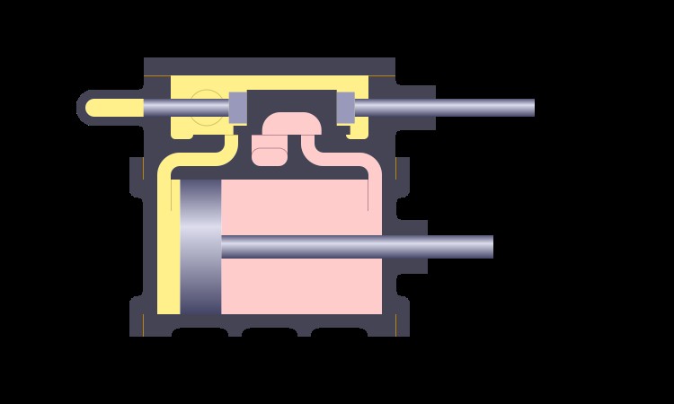

Condensate collects in the cylinders, steam pipes and valve chests during warmup, and compression of this liquid water is not possible, so it must be drained off during warmup. Normally drain valves are provided for this, however some engines do not require any action on the part of the operator. This is an advantage with simple engines having "D" type slide valves. The "D" slide valve is held against its seating surface by main steam pressure, and if pressure in the cylinder rises above this pressure, the "D" slide valve will lift off its seat. When the engine is turned over, and a slug of liquid water is pushed by the piston, the "D" type slide valve is lifted off its seat, and the water is carried away into the exhaust pipe. The condensate in the steam pipes and the valve chest travels out the same way, so the engine clears itself of condensate with the relief action of the "D" slide valves.

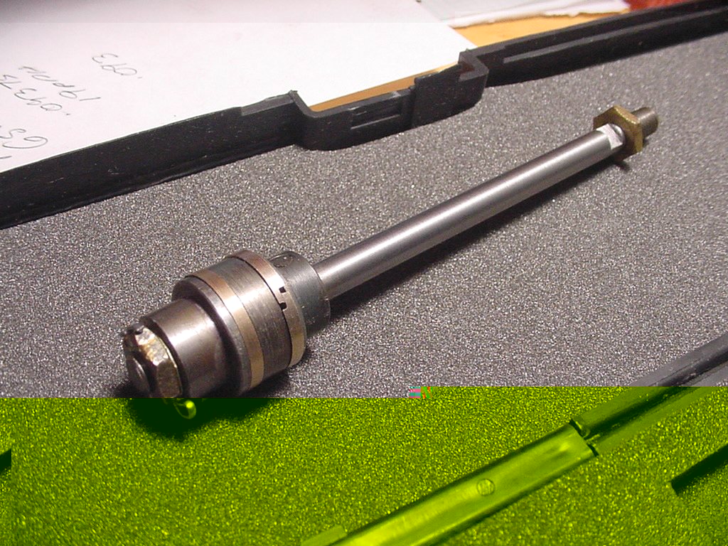

On an engine fitted with piston valves, this "self relieving" feature does not exist, so a separate set of drain valves are required. There are both manual and automatic drain valves, but that is the subject of another topic.
- D type slide valve
- stm cyl.jpg (22.95 KiB) Viewed 4705 times
- Piston valve for a small steamer
- T47PistonValve.jpg (228.51 KiB) Viewed 4705 times
