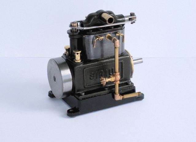

- Stuart Sirius 0.4 HP @ 2800 RPM
- Stuart_Sirius.jpg (30.48 KiB) Viewed 25775 times
