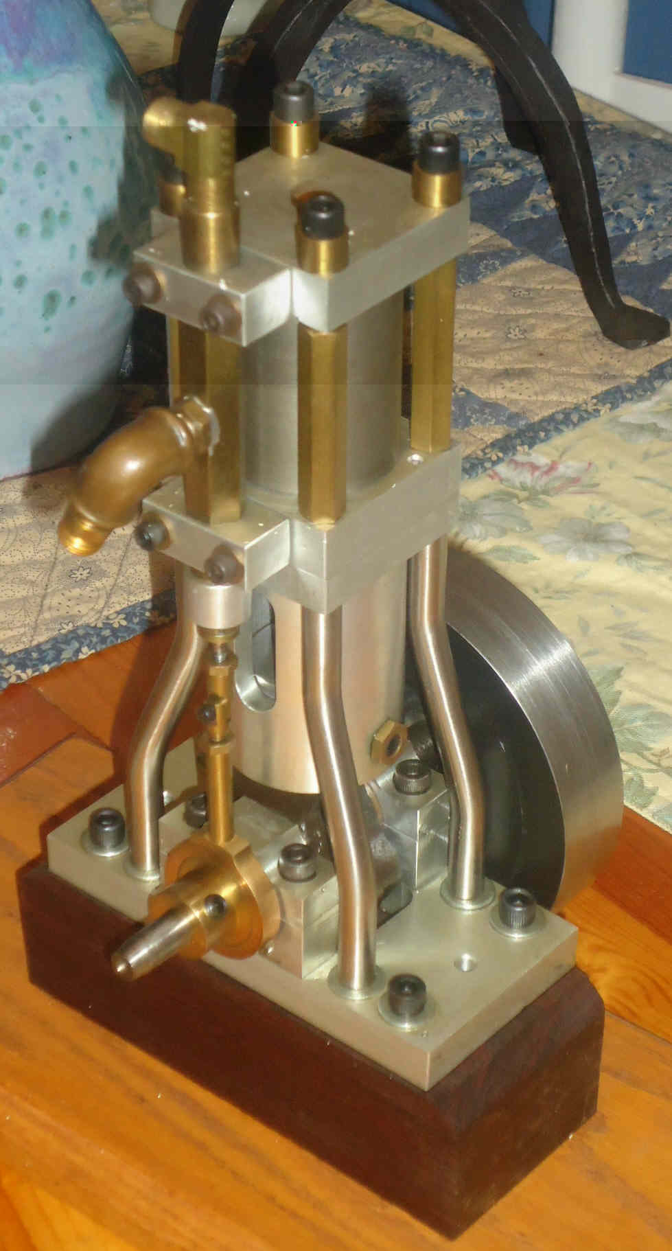

Just an example, a double acting vertical engine I built from a Homelite 28cc (1-5/16 bore, 1-1/4 stroke) chain saw crankshaft, connecting rod and piston. The engine has needle bearing mains and roller bearing connecting rod big end bearing, the original piston is used as the crosshead. This engine was made with no castings required.
- Flywheel is about 4 inch diameter.
- hom-view.jpg (106.2 KiB) Viewed 21189 times

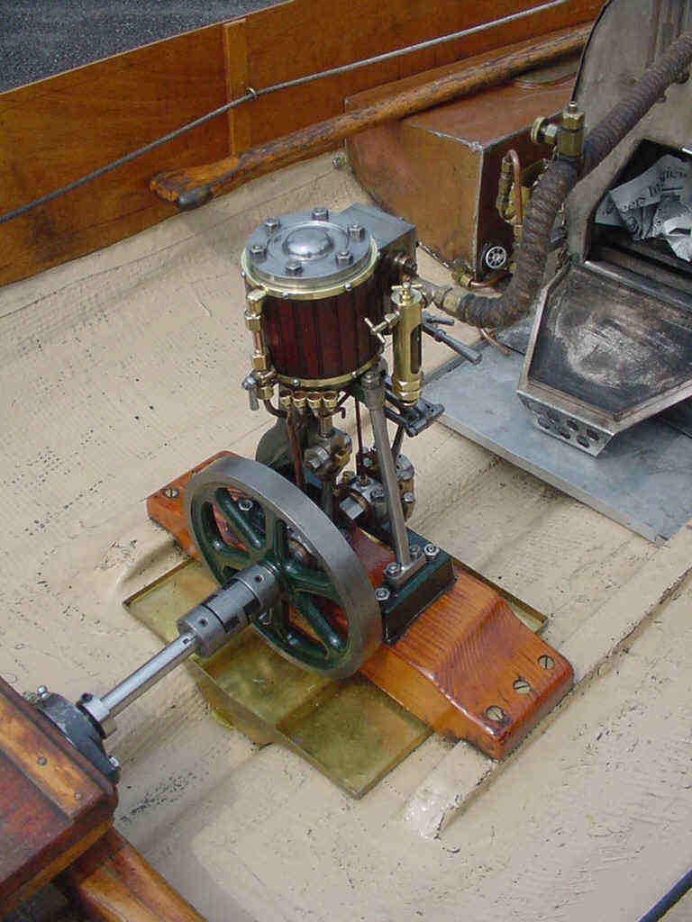

The steam coaster with Saito two cylinder engine. Next is Muskrat, a Wineglass Wherry, 12 foot long fiberglass boat with a Stuart No 1 engine. This boat, about twice the displacement you are contemplating, gets along very well with the Stuart No 1 engine.

- Stuart No 1 in Muskrat
- MUSK-ENGINE.jpg (67.5 KiB) Viewed 21185 times
