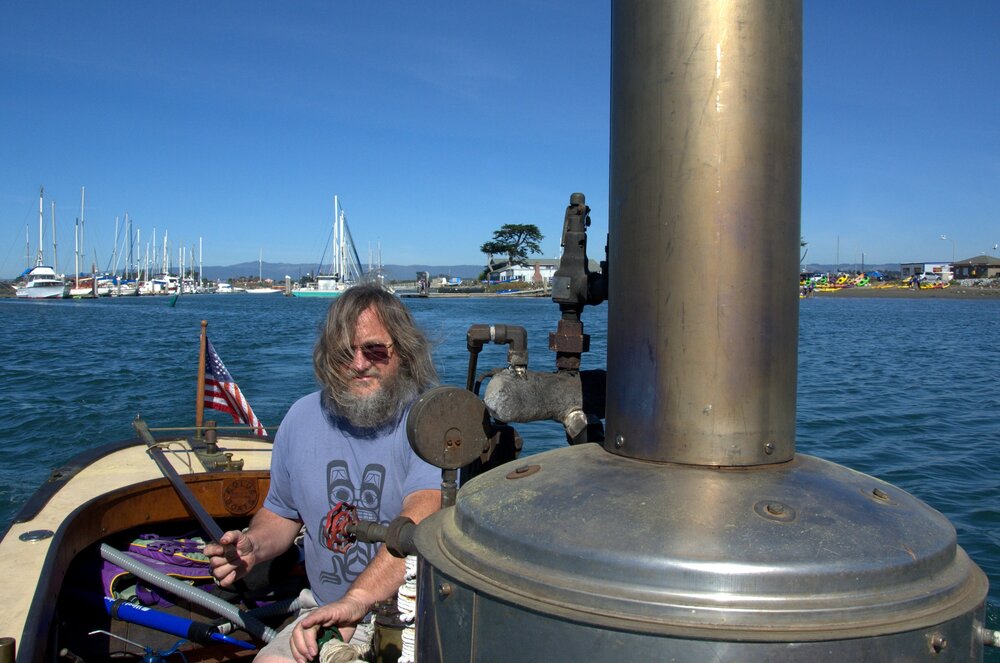

I had all sorts of issues with our 19' launch which had a long tiller when I acquired the hull; it originally had an antique gas engine fitted. The tiller would hit people in the head if I wasn't careful as well.
I ended up making a push-pull tiller (like is fitted on a small racing dingy) and that has worked well, although it confuses some people when I ask them to help steer :). Picture is from about 14 years ago....
