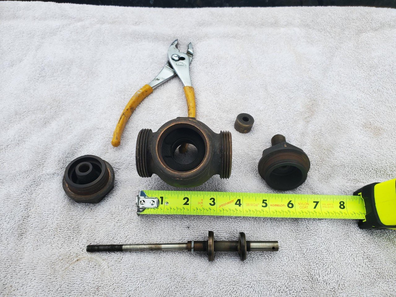

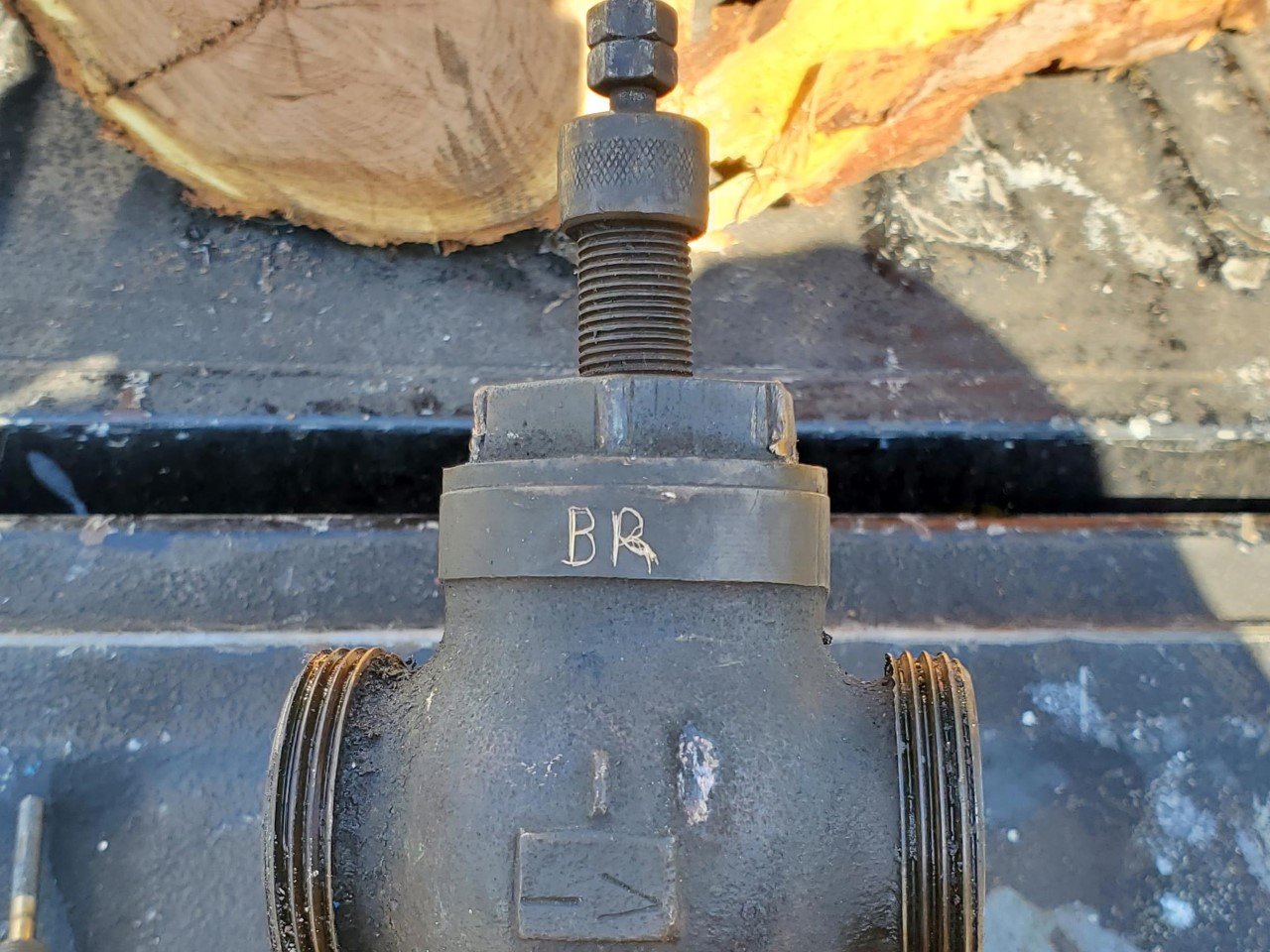

Does anyone know where I can locate a poppet valve like the one I am already using on TULE PRINCESS. These are used on her Walking Beam Engine for both INTAKE and EXHAUST. I know they are originally Whistle Valves, but these valves have been in service for over 37 years. One is wearing out and we are on the look out for a new one, or two.
The challenge is the intake and outflow fittings on ours are both 1.5" Male NPT fittings that connect to existing union coupling nuts. Everything I am finding on the internet seem to be female fittings. There is VERY little space for any connection modifications.
Trying to get a lead on who might have been their manufacturer. All that is cast into the body of the valve is a "1" and a direction arrow.
Any suggestions would be most helpful.

Yep. Rebuilding the valve or the valve seat is what I originally hoped to have my machinist would be able to do for us. He is about the Best in the area. But, he is growing more and more frustrated in not being able to get a good seal between the valve & its seat and balanced with the second valve and its seat. He is advising me to begin the search for a new one that might be more cost effective compared to what I may end up paying to have him rework this valves issues. It may have reached the end of its service life.

That's an odd valve. Looks to be a large metering valve for pneumatic service possibly. Fine threads on the stem. The special unions would be considered tailpieces.
As many boxes of old valves i've pilfered and surfing ebay, I've never seen a valve like that one.

Ok Guys, I did some deeper digging in "The Bible"- Captain's Logbook from the original owner and previous Captains. I am Captain #3.
What David Sarlin (Designer, Builder & 1st Captain) used for his Walking-beam piston INTAKE & EXHAUST Valves WAS.......
....Hoffman's Thermostatic Temperature Regulator Valves w/o the Thermostat control probe & associated connection hardware - JUST the double valve actuated poppet valves.

Thanks Bart. This same manual I stumbled over, but the graphics were not as sharp as your link. Gonna show this to my machinist tomorrow. I think we have the 05 Body configuration with the Union Connection.
I am still not clear if we have the 1" or the 1.5". There is clearly a 1 cast in the body housing (which is in good shape) above the directional arrow. But, the NPT connection size for the union is 1.5". I am confused as to which size I should be shopping for, should I decide to get a newer one.
I am with you. If my Machinist and/or Engine Specialist can get the seating issue worked out, I prefer to stay with exactly the Body I currently have and have three others just like it on the other intake and both exhausts.
