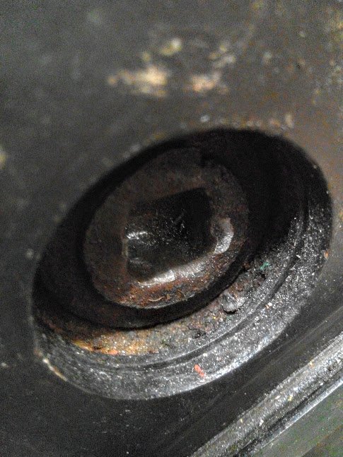

Pete sent me a photo today and I'm sure he wont mind me sharing it. Once seen it shows the obvious problem of even welding a stub to it, remembering also that the boiler is in the boat and this is a bottom plug, so at floor level. I/we have the kit, I'm sure a short (properly distanced) trip for me to Cheshire and we will have it sorted.
