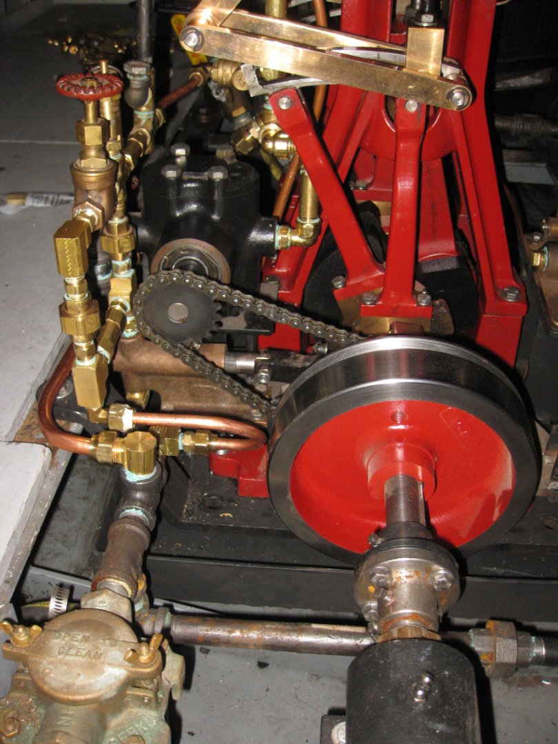

A billion +/- inboard speedboats, simply mounted the engine in line with the prop shaft and used a rigid coupler. That is how the tug is, no issue with it whatsoever. The engine is leveled and aligned with wood wedges under the motor mounts. Keep in mind there is some power loss going through a jointed coupler at an angle.
I made the one in the pic. For some reason, they are really expensive to purchase.
A little fussy to align using feeler gages, but once aligned, there is nothing to wear out or make noise etc.
