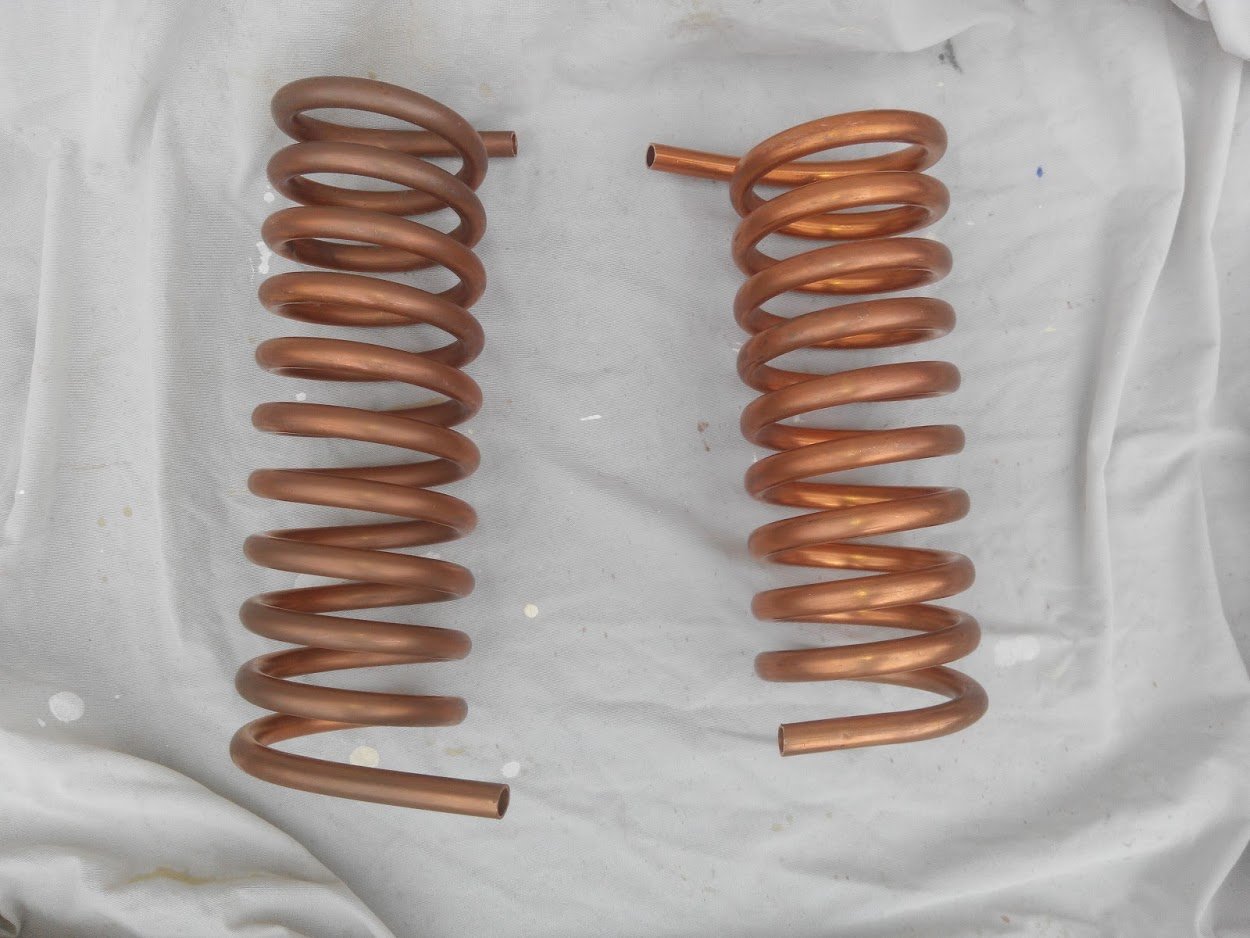

A set of 16 steam generating coils, 8 left hand and 8 right hand, plus the SBA Blackstaff Wood licence and drawing for the construction of one boiler. The coils are made of 1/2” by 18swg copper and were coiled for me by the late and much lamented David Beale. This was a boiler project that I never managed to get afloat. Also available, optionally, are my CAD sketches for a casing which is not provided for in the SBA documentation.

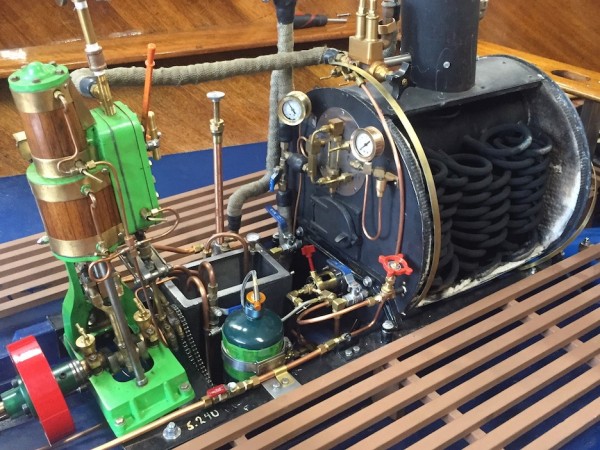

Just to encourage you, here is a picture of my new Blackstaffe boiler after one test firing.
So far so good, as I tune the oil burner for optimum combustion.
This new boiler is in its original casing from the 1960s.

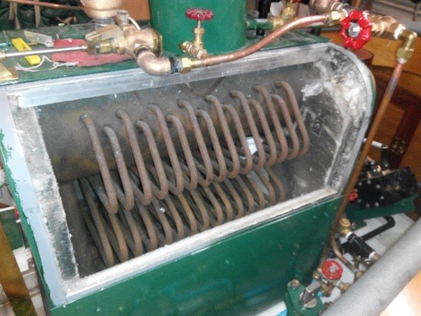

Hi Russ
Thanks for posting those pictures. It is nice to see the sort of things one can do with the casing for a Blackstaff. I have worked at length on trying to design a casing that allows for easy removal of the cover for tube cleaning. That will be a must for folks using coal, though the 'oilies' will not have that sort of problem. The first version of the casing for Frances Ann's Yarrow pressure vessel was nigh on impossible to undo once all the plumbing was in and the tubes soon got sooted up with dire consequences. The current version has high level removable panels that will come off without touching any pipe connection.
Access panel open (600 x 450).jpg (66.49 KiB) Viewed 86860 times
The sharp eyed will notice that I managed to drop a roll of PTFE tape down the funnel stub so the cover had to come off to retrieve it. Doh!

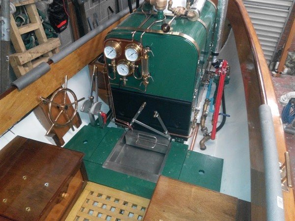

Since things look rather rough in that picture, here is a recent one in which everything has been sorted out, visually though not yet tested under pressure.
Boiler casing completed (600 x 450).jpg (70.61 KiB) Viewed 86861 times
Once the faffing little jobs left on the list are done, I will be twisting Mike Rometer's arm to see if we can raise steam for a short while.

Pete:
Nice to see your steam launch coming together. I'm on a similar timeline to yours.
The round boiler housing for my Blackstaffe boiler has two side panels that are easily removed.
They clip onto the top edging, and simple rotate down to cover the innards.
They are held in place by the two brass bands visible, if you look hard enough at the photo showing the open sides.
So: Remove just the two screws holding the two bands, and the side panels lift out and off.
Really a smart design!
Today I finished making my "kit" of accessories to perform periodic hydrostatic tests. So I'm ready to go.
I did a cold-air pressurization test, knowing that the boiler had been previously hydroed and steamed.
Everything is tight and works as designed. So hydro soon, and then steam tests.

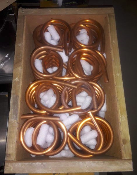

The parcels were delivered and all is well.
The cat is watching the paperwork.
