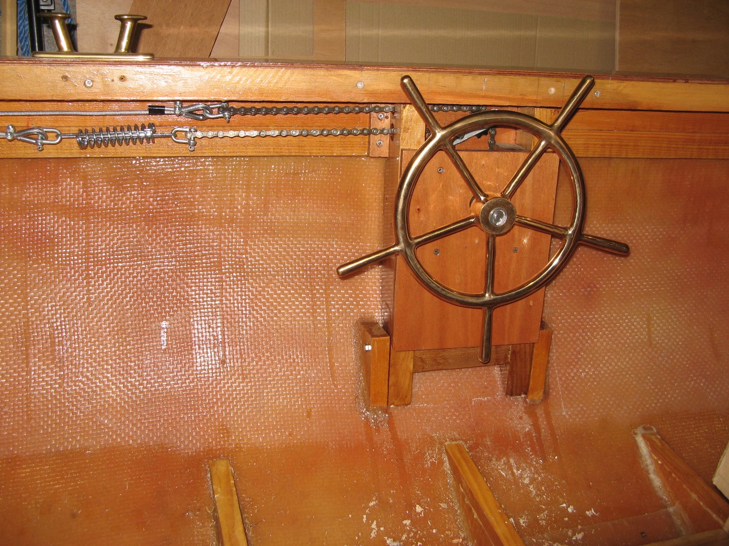

If you are not in a tearing hurry Paul Smith, son of Brian Smith of SBA fame, had a pattern for a nice steering wheel. I seem to recall that he arranged to get one cast for me in bronze and I have been very pleased with it. That was quite a long time ago so he may have had a clear out and dumped it. Still it might be worth the effort of an email if you like the look of it. Photo below if I can master the new system...

The one I’m looking at on eBay s quite similar to yours.
I plan to fit mine exactly like yours.

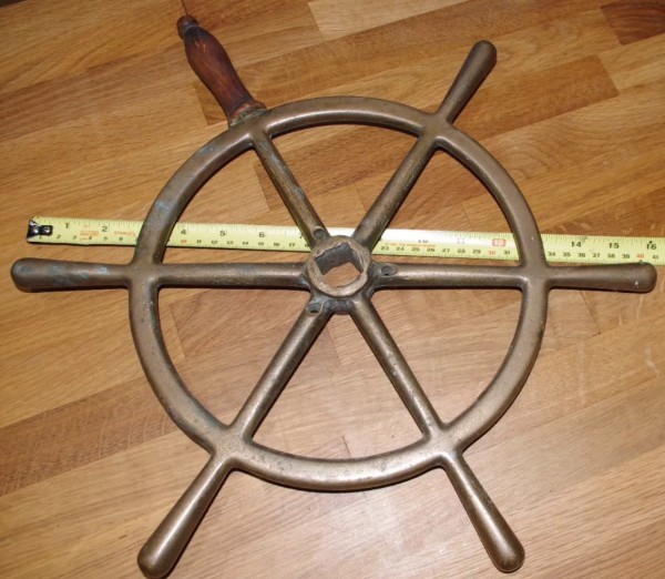

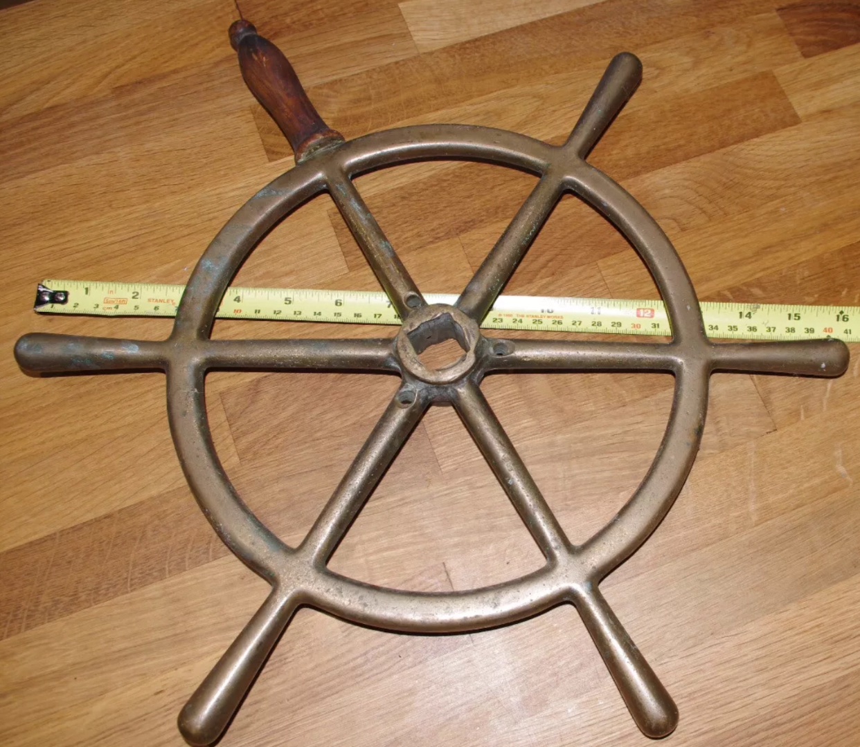

All sorted, just picked this up for £16.
Thanks for the advice.
Ian
Posts: 573
Re: Wheel sizes ?
Wow, the real thing! That looks nice and should polish up beautifully.
