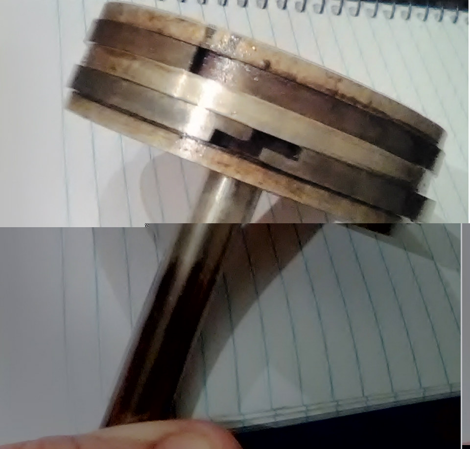

For reference...
1902 Toledo Rings, two per piston, different types.
