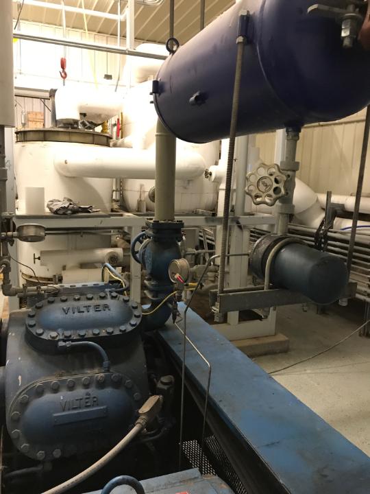

- Posts: 82
Re: single acting enclosed crankcase
Its actually reliability that im concerned about, I have free use of a three axis mill to make a set of heads, but no lathe. I would have to farm all turning out, and with the price of well balance compressor assemblies rated at 1500 rpm I think I can tune close to optimum piston speeds. I attached an image of what I basically want to scale down and run in reverse. Its its one of four 150hp single acting compressors with coalescing oil recovery (oil drops into float chamber and is returned), the white cylinder in the background is a fully flooded 163 tube vertical "fire tube" with main chamber and "steam dome" to the right. This compressor runs at 3500 rpm and is rebuilt every 20,000 hrs as a pm. But the working fluid is ammonia. I believe it will be easier for me to overcome the oil carry over issues than it would be for me to find a competent shop to machine a full balance rotating assembly, though I may be wrong. Steam is new to me.

- Posts: 1089
Here's a link to a web page about the first engine I had in Otter, which I made from
a refrigeration compressor of 2" bore x 2" stroke.
http://www.smaalders.net/bart/engine.html
I ran this engine for almost 20 years, until the bearings wore out due to lubrication issues
(it had served as a air compressor in a friend's business for 5 years or so prior to this).
It would still be running well if I'd set up some distance pieces and put double acting
cylinders on top... note that this was standard construction for ship's generating plants.
http://www.douglas-self.com/MUSEUM/POWE ... ss1927.jpg
The one I examined internally used a completely enclosed governor in the crankcase,
pressure lubrication, etc. and was still in great shape after decades of service.
An industrial air-compressor conversion would be relatively simple in terms of machine work
and you'd have an engine that would work quite well.

- Posts: 82
Industrial air compressor is exactly what I was thinking, mill a a head with as close to the same head spacing of the final head as possible but with a port for a fast acting pressure transducer tied to a data logger. Then use proxy sensors to fire selinoid valves to establish a data log before machining the proper monkey works mechanical system. Changing simple sheet metal flags on the flywheel and a two axis adjustment of the proxys with real time readout should recover more time from the math than it will take to do it. (Optimizing for one speed constant load)
