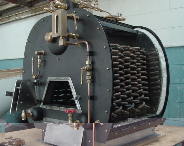

For a canoe, you might wish to consider a more horizontal boiler; something along the lines of the Blackstaff design would work pretty well. Given that you want to use wood, I'd see if a all-steel Ofeldt is practical, since boilers w/ copper coils are quite sensitive to water level. Winding the coils from 1/4" pipe should work; certainly the experiment there seems worthwhile and inexpensive enough if tried in the home shop.SL Ethel wrote:Does anyone have any data or experience to share with regard to fire space in a small wood fired boiler?

Thanks for the response. The horizontal Ofeldt certainly appeals from a height perspective - I'd like the boiler not to tower above the gunnel. And in the canoe, there would be no objection to making it very wide (relatively speaking). However, I've always been suspicious about the flow path for the combustion gas in such a boiler. From the pictures, it looks like most of the gas would pass up through the top of the coil stack without actually passing through most of the turns of coil. Is there usually an internal baffle? Or does it turn out not to matter that much? I've read Cliff Blackstraffe's article on these in SMSL (which looks a lot like the picture you posted).
Do you know if anyone is running something like this in a small size with wood fuel?

Hi Scott -
The advanced search here is useful: http://steamboatassociation.org.uk/page-1117882
I can find one boat w/ a Blackstaffe boiler that is coal fired. I think a stainless baffle over
some economizer tubing would handle any errant gas flow issues - certainly easy enough to do,
Keeping the weight low is really nice in a narrow boat - they can be exciting enough w/o tall
boilers.

Re: Fire space for solid fuel firing
This coming from a VFT devotee . . .
I wouldn't put a VFT in a canoe. Too high a C.G. and too heavy.
For what it's worth, my VFT-30 has a 12" diameter firebox with a water leg and I can drive my 3 x 4 single fairly hard. I fire it with 2" x 4" lumber cut offs around 4 to 6 inches long. Anything that I can get in there and still close the door seems to work fine.
I would consider a horizontal fire tube design both for the lower C.G. and the slower response to changes in load and firing. Hard to beat those Blackstaffe WT designs though.
