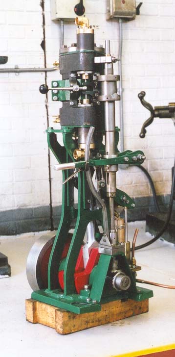

Each cylinder drain on this engine will have two valves, one right next to the cylinder as usual, and another a distance away. When used as a cylinder drain, both valves are open. After the engine is warmed, the valves that are a distance away from the engine are closed. This will greatly reduce the compression due to the increased cylinder volume. By placing the engine slightly after TDC with the timing shifting so that the valves are never opened, I'll move the timing adjust lever to cause the top valve to open. This should start the engine nicely w/ the reduced compression.
Key of course is warming thoroughly, and having a steam eductor on the condenser so we can start the engine w/ reasonable vacuum and an empty condenser.
I can also use a manual lever to actuate the valves; this is what Elpenor has:
http://www.elpenor.co.uk/pictures/engine/eng06.jpg
