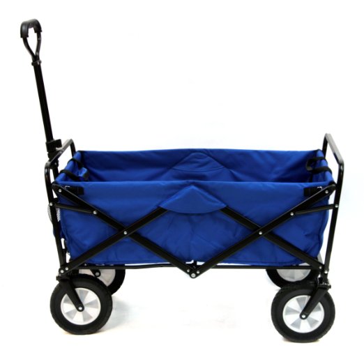

I second the chain saw suggestion, I carry a 24" bucksaw or pruning saw. It cuts pretty fast, and it requires no fuel and takes up very little space. Lots of dead wood along the edge and even a short walk in to any wooded area will result in a supply. We just need wrist sized stuff, no large diameter logs.
When I made the New York Champlain canal trip last year, Dave Conroy showed me a wagon they use and it works great for transporting a good bit of wood over a long distance. I have a folding handtruck that is better than packing it, but the wagon which I borrowed once was much better.
The one in the Pic is sold by Amazon.
https://www.amazon.com/Mac-Sports-Colla ... fold+wagon
