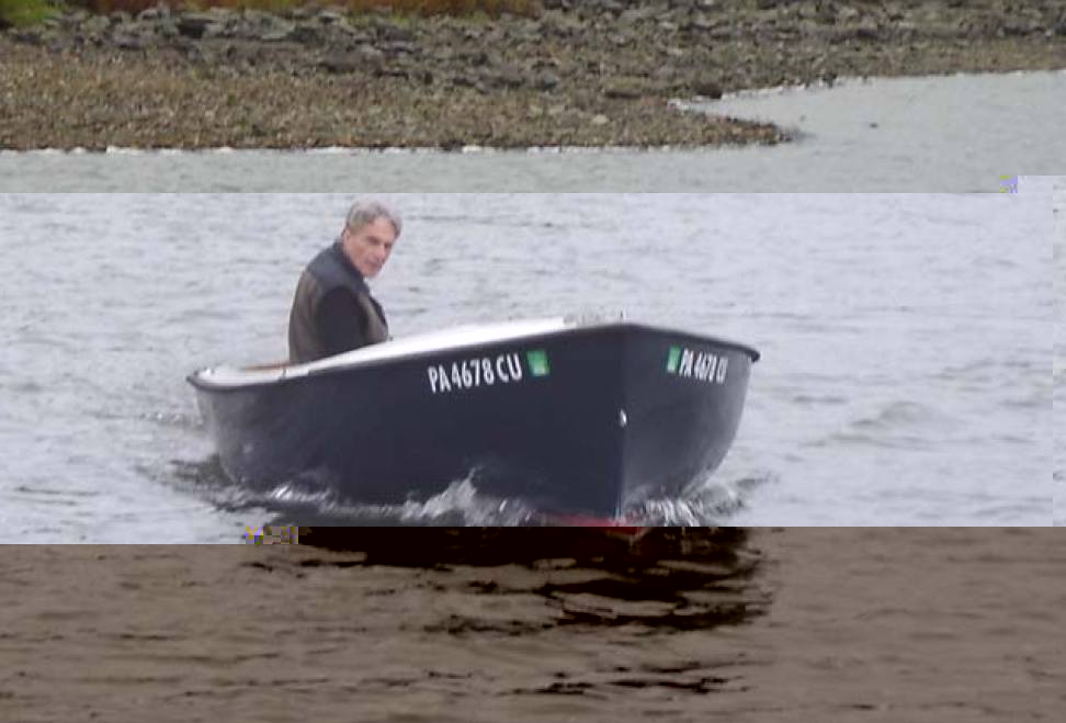

A used fiberglass sailboat hull can make a reasonable steamer with very low cost and much less labor than building a new hull. A small sailboat, with broken mast or bad sails, will sell for a very low price. I purchased a 14 foot Oday Javelin sailboat, with trailer, for $107 on eBay, a USA purchase, but similar circumstances probably exist where you are located. Cut out the centerboard well with ordinary woodworking tools, and fiberglass in a new propeller shaft tube (made from ordinary 1-1/2 inch PVC water pipe), you have a reasonable hull for a small steamer. Details available if you want. There is a complete description of this build on the Yahoo Group "Electric Boats", look up the file "Building an Electric Javelin"
This Oday project was originally powered with a 3/4 horsepower electric arrangement, and we could cruise at about 5 MPH with 4 adults aboard. I am now in the process of changing this boat to relatively high horsepower steam propulsion, but it would also be ideal for a much smaller steam power plant.
