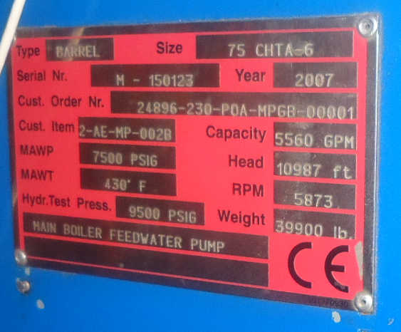

Just ran across this interesting Pump Nameplate, one of two pumps needed for the plant to get up to full power on a 1,000,000 + horsepower steam turbine electric generating plant. The plant burns about 7700 Metric tons of coal per day. Each pump is driven by its own 20,000 horsepower steam turbine.

Wow, how big is the economizer?
