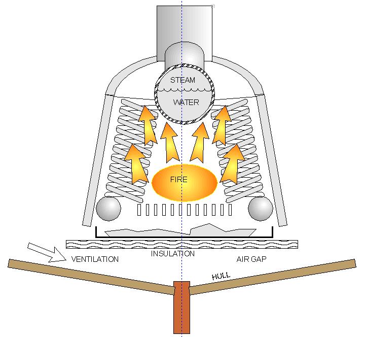

I second Barts input here, one or more layers of sheet metal, the closer to poilshed the beter, forms reasonably good insulation for high temperatures. A sandwich with 20 gauge sheet metal, stainless or aluminum, or brass for that matter, with about 1/2 inch between the sheets, and several layers of ordinary aluminum foil will do a good job as a heat shield. Air gaps are required. A real advantage in that the sheet metal and foil sandwich is not injured by water in the bilge.

- SHIELD.jpg (64.76 KiB) Viewed 19747 times
