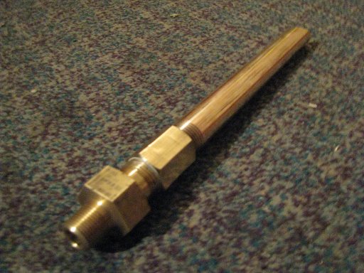

I have been running my current boiler with one, and I have bought one to put on my new boiler..
I'm curious if any have considered this or even know about it...
Safety/Relief valves are mechanical devices that can stick and fail to do their job. A burst disc has no moving parts. It will never fail to do it's job. But it's a one time use only. The one on my current boiler and my new boiler are 50 PSI above where the safety/relief valve should kick in. They should never burst. The concept is, no one conscious around can deal with the boiler and the pressure keeps rising and the safety/relief is stuck...
This may seem paranoid, but paranoia/caution around steam power boilers is a healthy pursuit .....

I'm not suggesting that my extra safety is for everyone. But I'd rather be alive with a dry boiler then dead because the boiler exploded.
Again - The burst disc should never break unless it's 50PSI above MAWP in my case.

I'm the only one then unless anyone anyone chimes in.
I understand the risk of gondolier88, marinesteam, and DetroiTug about it resulting in a potential very dangerous low water condition.
ASME steam safety valves can stick, I'm surprised that this isn't known to steam boaters - it is known in the US traction engine community. As I understand they don't stick to failure, they eventually will release. But I'm not comfortable with 15-20 PSI above when they should go off. You can lightly tap them and they will go off if they stick a bit.
I bought two and tested one myself to make sure it ruptured at steam pressure on my boiler. When I did that test I had a valve behind it and shut the valve behind it. It broke exactly at the pressure I ordered it to rupture.
http://www.mcmaster.com/#rupture-discs/=uheylf
It is - but I don't think anyone has gotten the purpose of this. It's a passive non moving fail safe that should never be needed when the operator is incapacitated and no one is around or no one is around.DetroiTug wrote:The best safety item is the operator.
Not really. They are engineered to rupture at a specified pressure. I wouldn't build my own.Scotty wrote:Question to CB:
How will you know that your rupture disc will open at the specified pressure?
Testing might be a bit difficult ....
