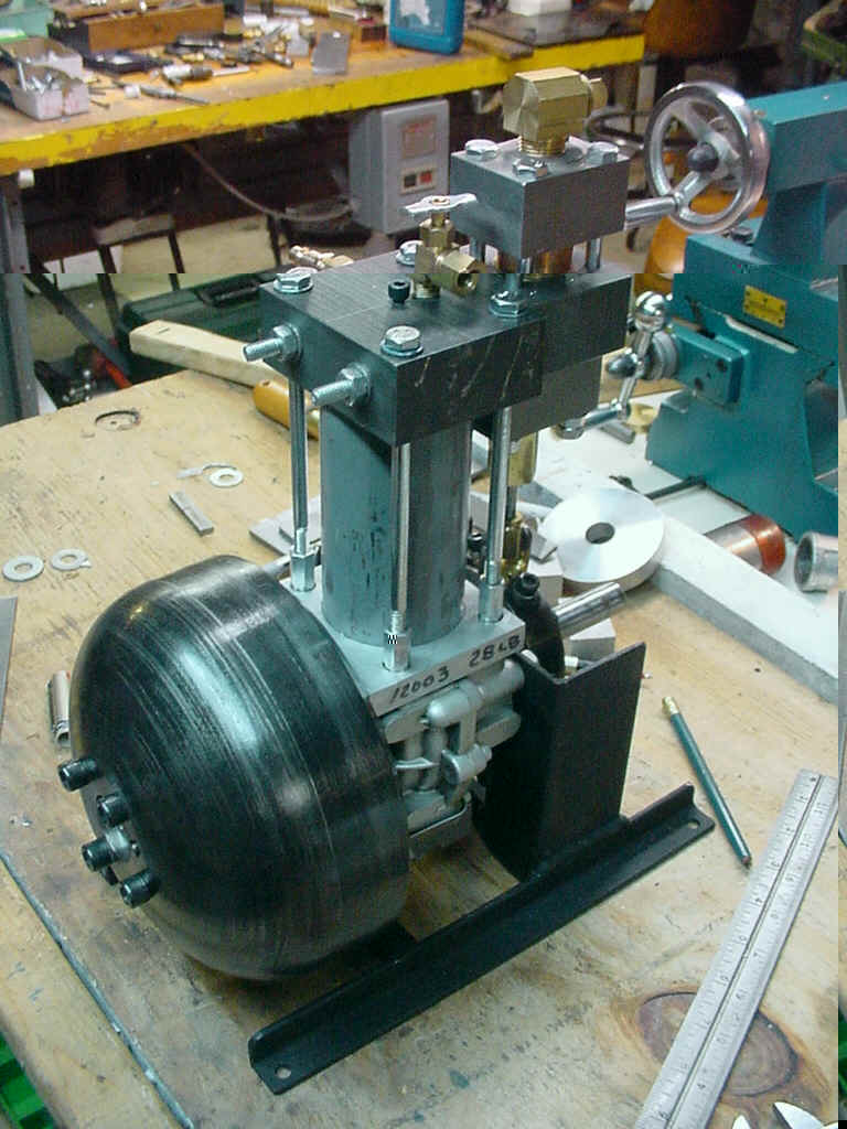

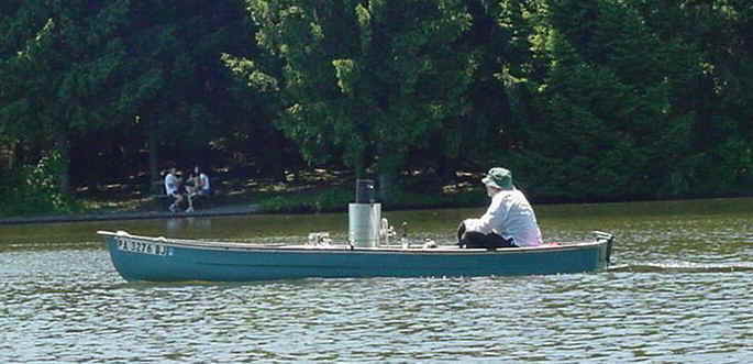

I have built a small steamboat plant from a 4.7 cubic inch (77cc) chain saw engine. The machine drove a canoe sized steamboat, producing about 1/4 horsepower at 600 RPM with 150 PSI steam.
The low speed of this engine, compared to the thousands of RPM in chain saw service required a heavy flywheel, I used a 6 inch Schedule 80 butt weld pipe cap for a flywheel.
This engine is somewhat more complicated than the typical "Bash Valve" we see on You-tube, having a lube pump which fed the bearings, and a substantial gap between the steam piston and the crosshead, which was the original IC engine piston. A hard chrome cylinder from a pneumatic cylinder replaced the original ported cylinder, and the unit had a conventional piston valve for admission and exhaust.
Engines where the piston pushes open a steam admission valve at the top of stroke (commonly called "Bash Valve" engines), and exhaust thru typical piston uncovered cylinder ports for exhaust are simple enough, but difficulties with lubrication need to be better addressed, and I think this would be necessary if anything is going to last much beyond You-tube video presentations.
I have also made steam engines from four stroke IC engines, and this is a better choice in my view.
- Steam Scanoe - From Radow's Steamboat Site.
- SteamCanoe1.jpg (27.72 KiB) Viewed 15621 times
