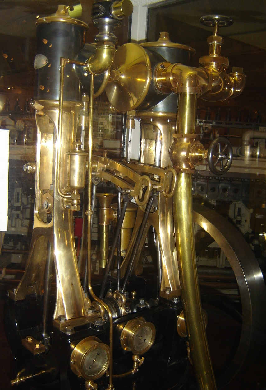

In the Henry Ford Museum in Detroit
What a beauty!!
COMPOUND HERSHOFF
COMPOUND HERSHOFF
