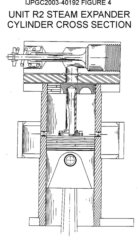

The Uniflow Engine on my domestic Heat-Power Module ran condensing, but on first trials the engine exhaust (1-1/2 inch open exhaust pipe) sounded exactly like a 12 horsepower tractor engine with a four cycle single cylinder gasoline IC engine. I have never experienced that sound on any other steam engine, however a common automotive silencer did exactly that, and the engine then made very little noise.
- R2 SectionS.jpg (100.84 KiB) Viewed 12941 times

Do you have any info on the poppet valve in the drawing: is it a manufactured item; where did you get any parts, etc. I have a Westinghouse compressor for a small truck air brake system. Three cylinder, excellent design, would make a great uniflo engine - just can't use a sliding valve like one could with a one or two cylinder engine. 2-1/8" bore by 2" stroke. Poppet valve would be great with uniflow - quick open and close, electrical solenoid activation to vary the inlet timing...

If you're going to vary the timing, use two cams and adjust the phase angle between them as Skinner did... you can do this
pretty easily using a mechanism like a 'phase variator': http://candycontrols.com/products/candy-phase-variator/
Various other mechanisms work as well, such as helical slots or sliding helical gears as Skinner used.
The valve is actuated from a rocker that rides on both cams, and the valve won't open unless both cams are 'up', so changing the
phase angle between the two cams modifies the overlap which is when the valve is open.
