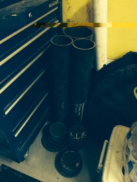

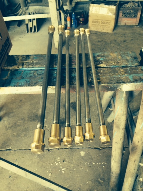

Well, here we go. i hope this goes well, i'll learn on the fly. End caps are almost done, I dont have a pic yet. But here's the drums, rough cut end caps, tie rods with finished nuts, and nuts before cutting the hex.
- photo.JPG (89.44 KiB) Viewed 19209 times
- photo 3.JPG (143.64 KiB) Viewed 19209 times
- photo 1.JPG (162.68 KiB) Viewed 19209 times

Looking good John,
what kind of material are the nuts made from?
Rainer
www.steamboating.de
www.steamboating.de
johnp
- Posts: 242
- Boat Name: Cardinal Queen
Re: John King Boiler build
Aluminum bronze

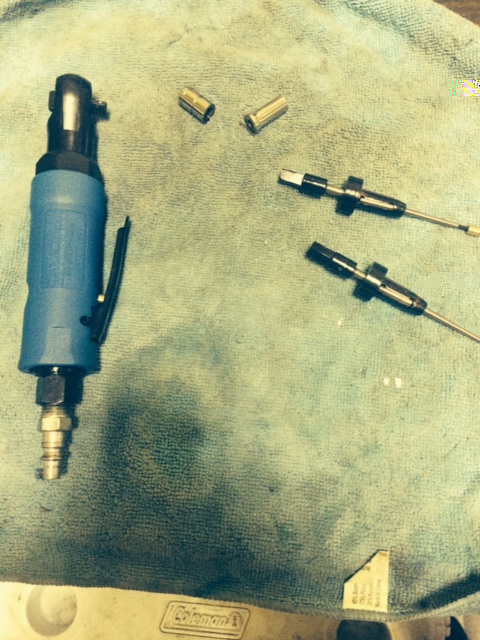

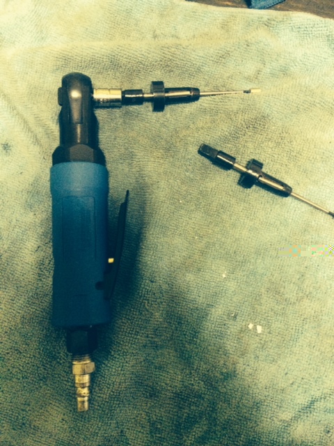

I think/hope this will work for my tube expanding, especially in the 4" mud drums.
I'm using a 1/4" drive air rachet and purchsed a 1/4" driven long socket, cut it before the hex starts so the square will fit over the wicksteed expander.
- tube expander2.JPG (160.1 KiB) Viewed 19132 times
- tube expander 1.JPG (154.47 KiB) Viewed 19132 times

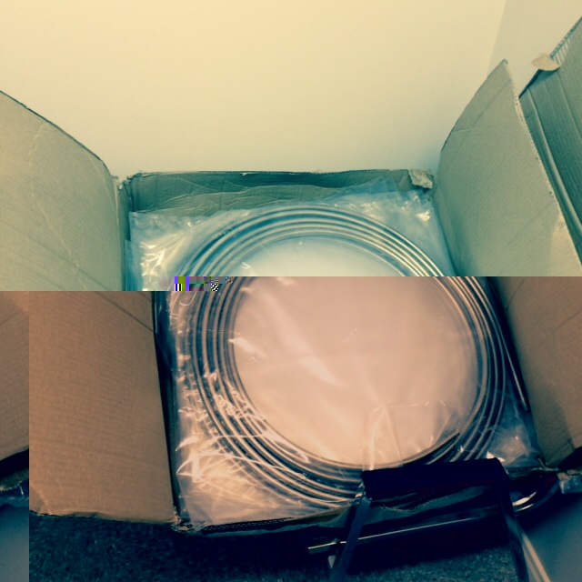

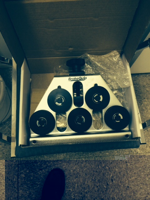

Cunifer tubes and straightener.
- image.jpg (106.72 KiB) Viewed 19124 times
- image.jpg (102.07 KiB) Viewed 19124 times
- Posts: 860
Very nice John. This is going to be neat to see.
What size tubing are you using and who are you using for a supplier? Is it 90/10 or 70/30 alloy?
johnp
- Posts: 242
12mm 90/10 from Dorset tube in the U.K.
