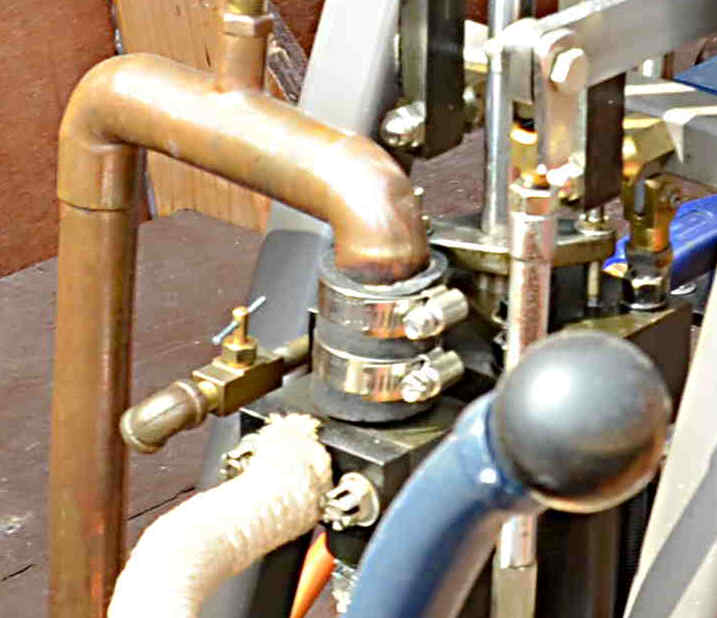

I have a heat exchanger on my exhaust loop to allow for preheating feedwater if I want to. I am currently not using it. I have about 3" of Rubber hose connecting a pipe nipple on the black iron pipe coming off my engine to the exhaust inlet side of the heat exchanger. I have a similar set up on the outlet side where the exhaust heads off through my condensation loop.
Will I run into issues at Lee's Mills ? It sounds like I am technically non compliant.

Jon, where did you get the Lee's Mills safety rules? I plan to attend and want to be sure I am OK for the rules.
Several short automotive radiator hose pieces are in my exhaust piping, with no valves that could restrict free exhaust flow from the engine. I would think that, if there was no way to restrict the exhaust steam (such as an isolation valve on the steam flow to/from the heater) then the presence of a feedwater heater in the exhaust line would be irrelevant.
I believe you got a feedwater heater that looks like a piece of copper tubing, with a water jacket surrounding the central steam pipe? If that is the case, then it is really no different than a piece of exhaust piping, provided there is no valve in the exhaust path, and the heater steam flow path does not restrict exhaust flow.

Those rules would prevent me from participating. The hose I'm using on my exhaust is after a feedwater heater, although the heater has been omitted from the feedwater supply - so it's essentially not there. The hose is exactly the same hose used for the exhaust on my Chris Craft which sees intermittent temperatures much higher than on the steamboat. It's connected to a 1" open pipe in the stack, no way is it ever going to see boiler pressure. Three years of service and it's doing fine.
Regarding the "delivery side of an ejector" the rules mention it's permissible to use hose here. I disagree with that. If the ejector fails to pick up water then it's steam at boiler temperature and potential boiler pressure on the delivery side, at the very least, steam rated hose should be called out. I'm mounting an ejector as a bilge pump and using iron pipe on the exhaust side. Also installing a valve on the delivery side that can be closed to flush out the pick up.

Did some checking on the origins of the new rules:
The prohibition of riveted boilers is tied to a boiler explosion, where an old, uninspected rivited boiler was put into service with no preparation or testing, and failed. Evidently rivited boilers, such as many locomotive and traction engine applications will be getting more rigorous inspections because of this, probably more of an expense than a small steam launch owner would like to endure.
The prohibition of rubber hose for steam service applies to steam hoses thatcould be pressurized, not to hoses connecting to atmospheric discharge with no restrictions or valves that could result in pressure buildup. Many steamboats use automotive radiator hose for steam exhaust lines, and if in good condition, without restriction or valves, will continue to be allowed at the Lees Mills event.
Reinforced Automotive coolant hose, with hose clamps, is rated for 15 PSIG / 250F service and is routinely used for non-pressurized steam exhaust lines.

Thanks Fred.
It looks like I will be OK. No valves down stream of my hose joints, open to the atmosphere.
