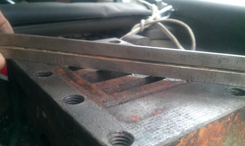

As for cast iron on cast iron... Here's a picture of the hp valve face on my father's Scripps compound after the use of superheat, and with steam cylinder oil at one drop every 100 revolutions, 180RPM, 150 psi. Non-balanced d-slide valve.
When she was in the water regularly we ran her every evening during the summer for 6 hours at a time. This is after 5 years use.

Of course we all agree with gondolier88, good cast iron and steam oil. That has been proven many times. Spilling experimented with several options and found none successful without lubrication, except for piston valves, tungsten carbide on tungsten carbide. Those engines are rated up to 750F I believe.

I really think that this is an area where copying full size practice would pay off. What I mean is using a balanced slide valve.
Not something crude like just an O-ring but done properly with a telescoping insert. There several parts to such a thing but none of them that hard to make from scratch. The resulting valve assembly runs at a uniform temperature (all parts at the same temp as each other even over a wide range) so the fits can be close.
One look at that worn valve face should make a believer out of anyone. Superheat has its drawbacks. Let's hear it for saturated steam. I know. A luddite.
