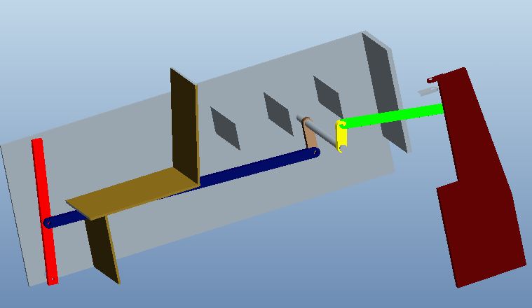

In the moment I try to simulate the tiller or better stick stearing by (with? in? english wording please) CAD.
The green lever is assembled with two ball joints. The rest of the joints are from ordinary pivot type.
My questions:
1)
What is the American and/or English boat direction for pulling the lever?
I will use two sticks - one at the left and the other at the right side of the boat!
2)
What is a good (proven) stick travel at the top to balance a good feeling for holding the course with not to much hand force nor needing to much moving with the arm?
Practitioners first please!
Re: First core bockes
"With" maybe better; or "in"; Rainer, either would do. You worry too much, we understand. English is very flexible.
I still admire how you whip up these CAD drawings. I am still trying to understand the basics, and am much quicker with a pencil and paper. :lol: :lol:
