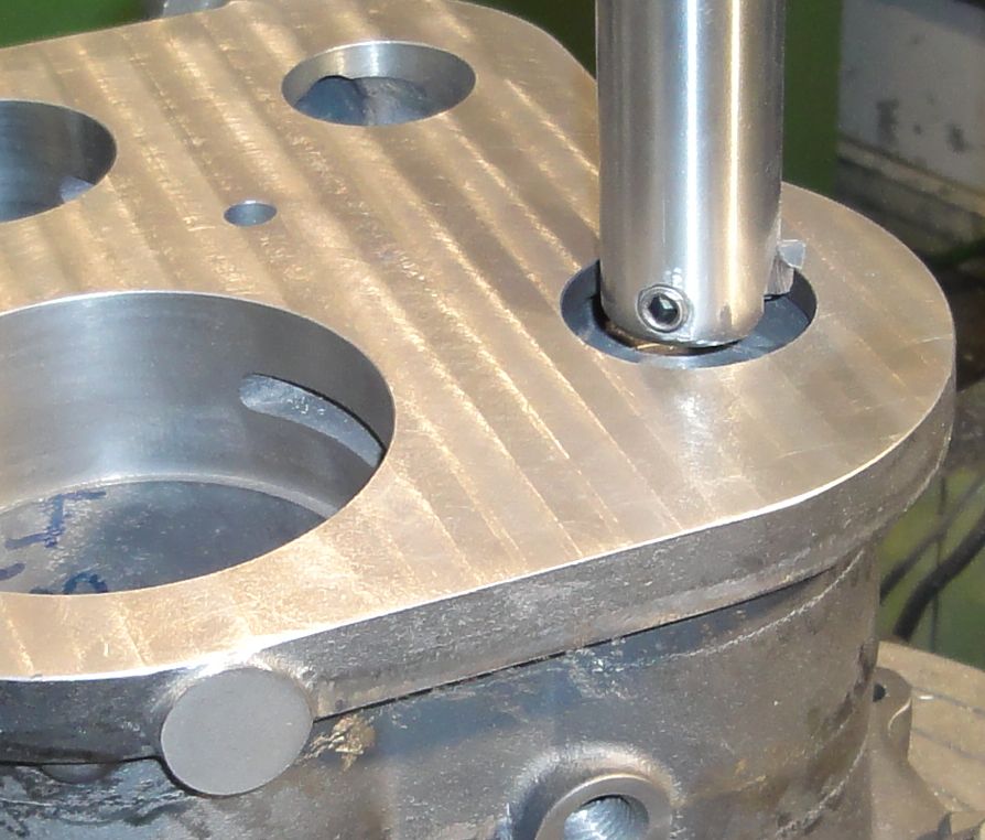

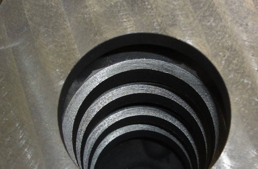

Today I machined the control edges of the LP piston valve cylinder. In this view you can identify the situation:
HP piston valve cylinder at the left - LP piston valve cylinder at the right
The steam ports are already build by the sand cores. This cores are forming the control edges with about 2 mm machining allowance. So now I had to remove this machining allowance to get sharp and well positioned control edges for the piston valve. In the drawing above you can identify the machined surfaces as rings with little steps up/down to the casted surfaces.

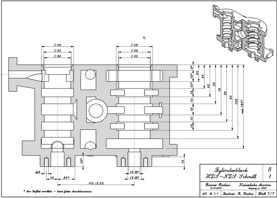

At the following drawing you will find all the control edges and the dimensions of the cylinders (all dimensions in mm - right click to all my pictures to open them enlarged).

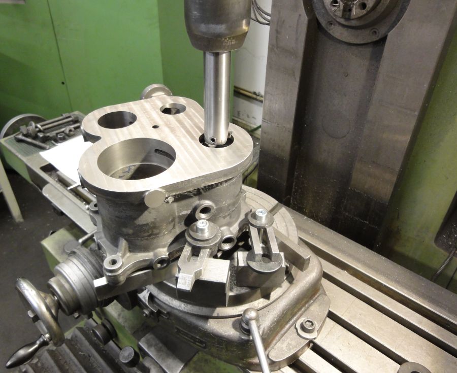

Because I am back at the fully manual operated mill, I used a circular table and my self made boring bar. The cylinder bore was aligned to the circular table center. After bringing the boring bar to the appropriate depth I moved the x-axis in steps of 1 mm. After each step I turned the circular table 360 degrees by hand. This produced the necessary groves/control edges.
To cut the upper and the lower control edge I had to mount the cutting tool up- and downward while turning the spindle clockwise or counterclockwise (upward position shown)
The result is fine. It is not necessary to have a super fine surface at the steps but to have a sharp edge to the cylinder surface. No defects in the casted part. But hard to take a picture of a hole dia 45 and 120 deep ...

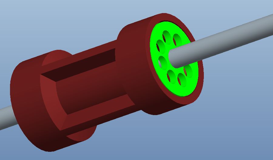

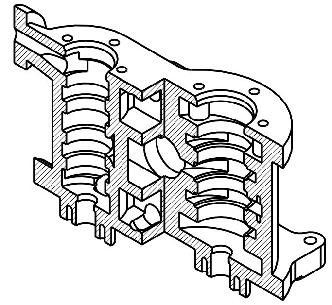

Yes, that is true and corresponds to the original design. Only with this feature you can machine the port edges (is there a better steam talk word?) direct into the casted part.fredrosse wrote:Is it correct that the piston valves will have no liner sleeves?
At my Arkona engine I am using the classic design with a liner and port bridges for piston guidance:
From left to right: casted valve chest, liner, piston valve.
Liner - intermediate machining status - top and bottom not trimmed - pors at the right already filed to a squared shape.
But even here I do not use piston rings. Maybe I could save some coal with valve piston rings but I prefer the "kiss" principle and have no performance problems since 2005...
It was not me. the engineers from 1902 did this already. At this blow-up you can identify the solution. If this is a good or bad idea will be shown in some month (years...) - at least I can bore a bigger hole and use the regular liner sleeve solution afterwards.fredrosse wrote:I thought that sleeves are necessary to avoid having the piston valves (or piston valve rings) catch upon the ports ... it seems that you probably have already thought about these issues.
This is my rough design of the piston valve with the integrated "bridges" to protect the piston from "falling" into the ports.
