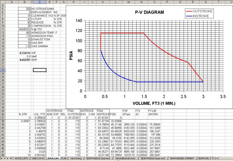

Re: Engine Design RPM
In performing my employment in the steam power industry I have developed many EXCEL spreadsheets to help design and analysis of many systems and machines. I build these during the last 20 years during my "day job", and some of course deal with reciprocating engines, boilers, combustion, draft systems, and of course some marine analysys work. I have several that present in both Metric and English units. I do not know how to share some of these files with you, if you could tell me a method to do this.
As a starting point for developing EXCEL programs relating to our steam launches, look at the functions presented in the FAQ section of this forum.
The texts recommended by Bart are much better, but will require significantly more study.
