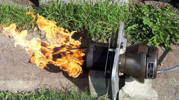

Hi,
yesterday i have tested the burner to find out the right hight of the fuel tank above the burner - best result where given at 80 cm.
The video you can find here - https://youtu.be/n6Rwhb-rlSs
Best Dietrich
Best Dietrich

I've worked with Kerosene burners quite a bit. Something is not quite right with this burner. It appears to be atomizing fuel, which is small droplets, which don't burn well as shown in the video, yellow sooty flame. The S-shaped plate below the flame is probably intended as a flat plate vaporizer (gets hot and turns the droplets to gaseous for complete combustion), but it's not vaporizing anything, only collecting soot. I think that possibly this burner is upside down in these tests or it is designed to be used vertically not horizontally. Burning as it is would cover the interior of the boiler with a thick layer of soot/carbon in a very short time. Soot is a very good insulator, even a light (1/16" to 1/8") coating on the heating surfaces of our cars degrades performance significantly. One inch of carbon has an R-factor rating equal to about three feet of standard insulating materials. Kerosene should burn blue for complete combustion and the maximum amount of BTU/gallon. In our cars yellow flame is bad, but that is generally the result of inadequate primary air or low fuel pressure not drawing the required amount of air in the mixing tube, but we are using a liquid vaporizer over the fire "pre-mix vaporization", this type of burner is considered "post-mix vaporization" type. It doesn't appear to be doing that.
It will behave differently in a combustion chamber where the plate can reach the required temperature mostly isolated from the outside air.
