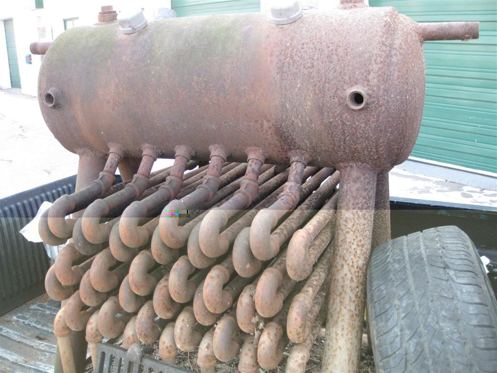

Regarding threaded water tubes, the boiler below was reportedly built by George Whitney with right and left hand threads. This is the boiler that was originally with a Whitney compound that has been copied out east and in a few boats. It was listed for sale in Modern steamboats in back of one of the issues and purchased many years later.
