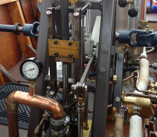

The Margaret S. has 9 notches forward and 9 notches astern. This is controlled with a brass handle (about 1 inch diameter x 4 inches long). A twist of the wrist (like a motorcycle throttle) loosens the latch, then it swings up to unhitch from the link-up notches. I then shift to the cutoff I want, and swing the lever down, engaging the link-up notch I want. If I am going to keep that setting for a long time then a twist of the wrist draws the lever into the notch plate, so everything is tight for continuous running. All this is one hand operation.
Reverse Lever, Brass on right side of engine frame.  Marshall-Bremme Valve Gear
