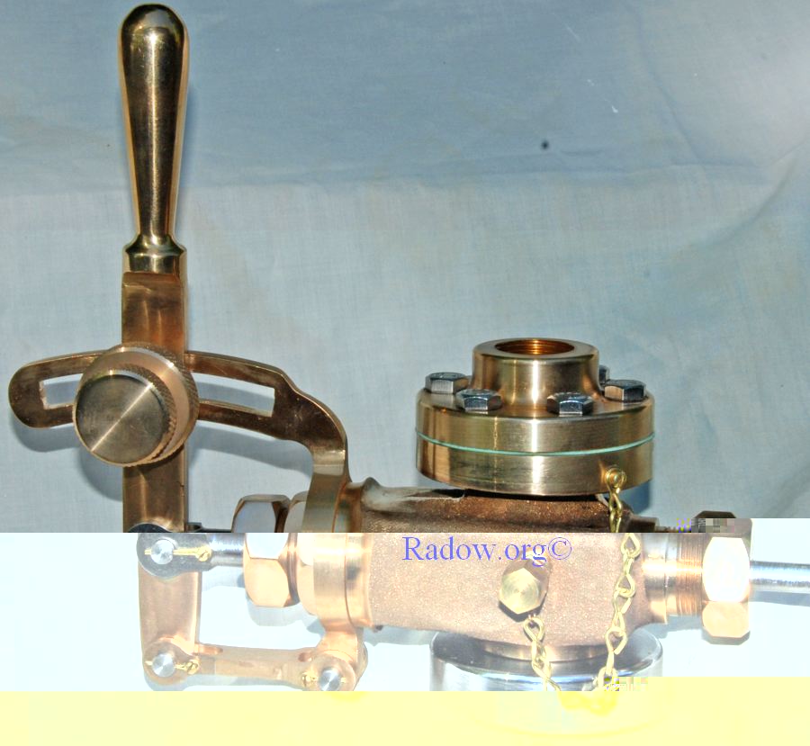

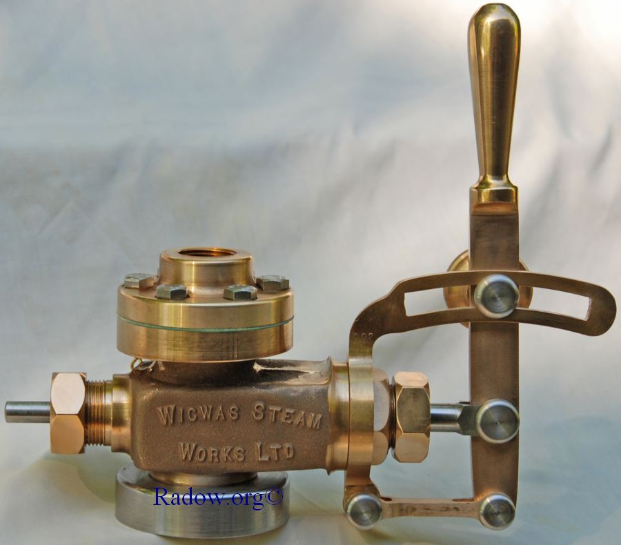

a friend of mine asked me to machine a valve.
First off all I thought "Why making your own valves?"
Than I got this pictures as appetizer: It's a replica of a US Navy Type K Engine valve. I already found a picture of the original in the "STEAMBOATS & Modern Steam Launches" May-June 1962 issue.
Now I am desperately waiting for the over seas parcel with two sets of castings and hope to convince the customs officers not to take all my holiday money to buy Miss Merkel a new NSA proved cell phone.

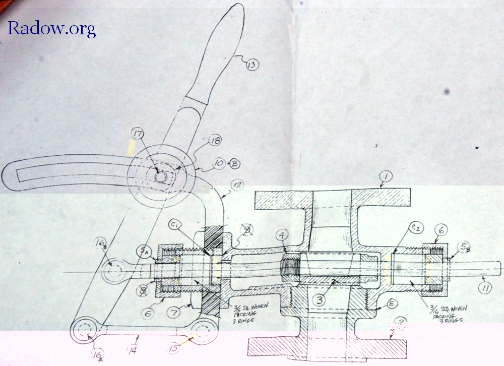

Till than I will make new metric 3D drawings of all parts - first start:

That is a beautiful throttle valve. How did that work inside? Is it a sliding cylinder with a cross hole? Or is it a tapered cone? I can see the cylinder for flow regulation, but it would be difficult to seal it 100% off. A tapered cone could seal completely. I'm working on a Locomobile steam car project and I think it had the same type of throttle. Straight push and pull in the body.
Re: US Navy Type-K VALVE
That looks like boat jewelry to me... where can one get those castings

Have a look here - it's a D-valve. If you like you even could give the valve plate a V shape or what ever design to enable a fine opening curve:You can mount/remove the D-valve (3) through the bottom flange (2). I will change some things of the connecting rod (11) and valve design but in general will take over this layout.

Those are the valves that Dave Thorpe made for his steam lunch Wicwas, he printed the story in "The Smokestack" printed by the North American Steamboat Association, castings,drawings, notes, bill of materials and a DVD of photos are available from Dave.

Yes, I got it all from Dave.steamdon-jr wrote:are available from Dave.
He also allowed me to publish this pictures and drawings.

Is this a copy of an original valve? A few features are a bit confusing. Behind the valve seat there is a "plateau" or raised surface drawn in line with the surface of the valve seat for the valve to transfer over to in the open position(left of numeral 3 and below the numeral 4). From the drawing it looks impossible to machine (without a special right angle boom).
