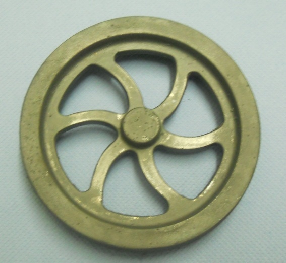

AGAIN I have a question, I am about to order a new flywheel for my ST 5A and I am not sure about the weight. At the moment I have a solid flywheel of 2.3kg (5 pounds) and 133 mm diameter which is badly machined and has a wobble.
The new flywheel I am considering is a spoked one with a final weight of about 1.8 kg (4pounds)but a diameter of 150mm.
Now the question is: will this flywheel still have sufficient weight for boating application since the diameter has increased which (according to my thinking) allows for a reduction in weight to have the same effect as a smaller heavier one?
PS: I know that there are stuart flywheels meant for the 5A but personally I think they are too big, if iI remember correctly the stuart ones are 7-8 inch (180-200mm)
Kind regards Quinten Versluis

When the engine is coupled to a shaft and propeller, the flywheel weight is not as important. A smaller and lighter spoke wheel should be fine. I ran my engine with no flywheel, I only added it as a test to resolve an engine shaking issue and to add some weight plus have something to grab and turn the engine when adjusting valves etc.

The main reason that single cylinder engines have flywheels is so the energy stored in the flywheel will carry the crankshaft, and therefore the piston , past top and bottom dead centres and so allow it to run properly .
This doesn't apply for a marine engine since the motion of the boat means that water passing through the propeller will turn it and so also turn the crankshaft and carry the piston past the dead centres .
BUT... there is a very good chance that on stopping the piston will end up at one of the dead centres so there is still a requirement to bar (turn) the engine past the dead spot when you want to restart , so some sort of a flywheel or barring wheel is needed . It doesn't need the mass of a land based engine's flywheel because as explained above its purpose is slightly different .
So you can choose how big you want it to be to be convenient to either kick or turn by hand to get off the dead centres . If you opt for a solid wheel it is usual to drill a series of holes around the circumference so you can put a bar in to turn the engine with precision if you need to adjust the valve timing etc .
Regards Edward.

Thank you for the detailed explanation, I completely forgot about the influences of the water flowing through the propellor, i was solely fixed on the idea of whether it would be able to pass top and bottom dead centres.
I decided to order a similar flywheel as the one described earlier, same size but slightly lighter (1.5kg) but a much nicer design, in my opinion.
Regards Quinten
