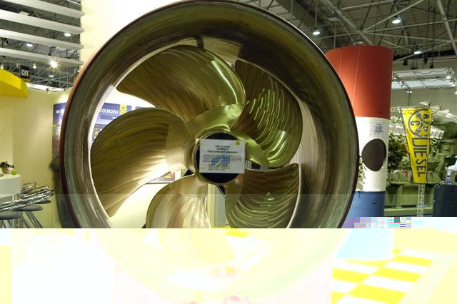

I was actually thinking more of a real ducted propeller (kort nozzle) where the tapered duct together with a well suited tight fit propeller, created more thrust and therefore more speed and efficiency on displacement hulls.
Ofcourse the duct and propeller have to be carefully calculated, not just place a duct around it which is randomly tapered.
Something along the lines of the pic posted below, ofcourse much smaller scale and larger tolerances, pfcourse it will not be a cheap setup, but that is a relative term with steamboating I suppose.
Regards Quinten

I'm not sure I agree that Kitchen rudders are ineffiecent, but I digress, Kort nozels do make quite a difference in tractive effort and are popular on tug boats. I'm not sure how much gain it would supply to a small propeller on a steam launch however. Give it a try and record your results, would make an interesting thread for the forum.
Keith

http://www.submarineboat.com/kort_nozzles.htm this page has some info on small Kort nozzels. Wickipedia also has a concise description of the promary nozzel types and application.

Let's see. With a power plant that will never see 4% thermal efficiency you are worried about propeller stuff? If it were me, I'd put a lot more effort into insulation and feed water heating.
Not that it isn't possible to have the wrong prop on a boat but if you stay within reasonable bounds, I suspect that the efficiency gains from exotic setups are likely to be illusory.
In my home waters there is a fair amount of weed and kelp and such. A nozzle of any sort looks like a wonderful chance to end up rooting around down there in cold water getting things cleared out.

Paul Eaton here in New Zealand has put a Rice nozzle on his steamboat, but the boat isn't finished yet. Paul is on this forum, andwill no doubt be able to give a lot more information when he sees this. Will be very interesting to see how it works out.

I wasnt really thinking of efficiency in the sense of reducing fuel consumption, but more in the sense of solely improving the efficiency of the propeller.
Basically, trying to get the power you currently have and convert it into thrust.
The whole point of subject is to see whether ducted props on a smaller scale would make as much of a difference as thoseon larger vessels, and whether it would be benifical to place one.
Ofcourse it would be less efficienct since it would not be professionally made, but I suppose it can make a significant difference.
Luckily where i will sail i do not have to worry about weeds etc.
Regards Quinten

I know of one steamboat with a ducted propeller, it is called Juno (details in the SBA register here :
http://www.steamboatassociation.org.uk/ ... Id=1117882)
I seem to remember the owner saying that he didn't think it was any more efficient in practice but that it was very good at picking up plastic bags which were almost impossible to remove when afloat.
