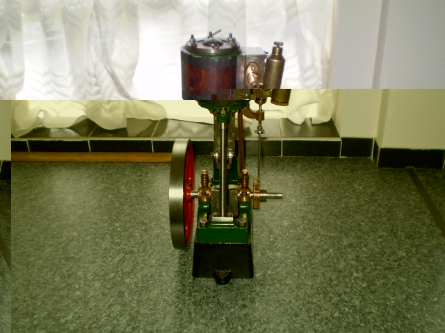

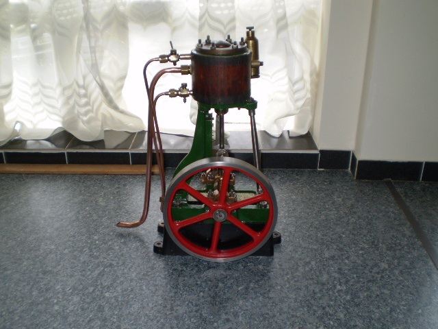

Re: My first steam engine
Mike.
I like the traditional look too, even on the boilers with copper smoke goods. My little Stuart #1 has wooden cylinder lagging and I think I will leave it.
I will add some new brass bands too.
Hayden
Hayden

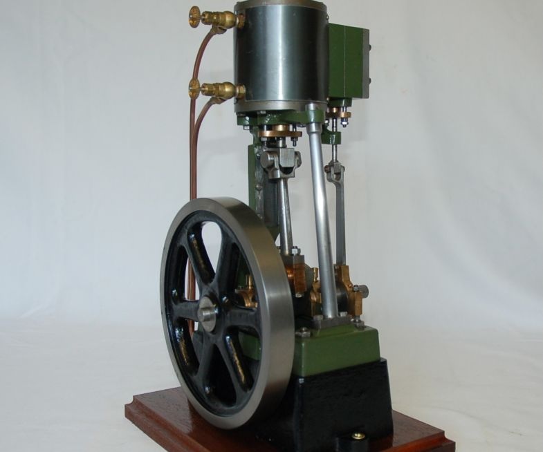

- image.jpg (111.46 KiB) Viewed 9386 times
- image.jpg (111.26 KiB) Viewed 9386 times
